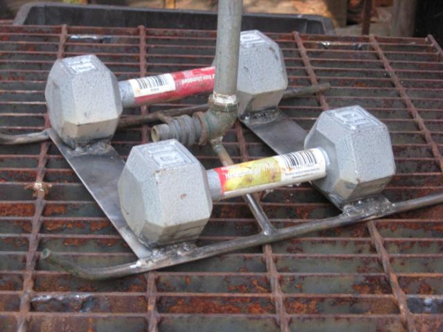

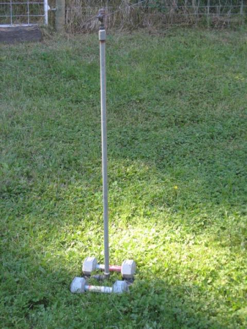

We had a sprinkler stand that didn't work well after I changed the sprinkler head atop it to a "rainbird" type - the force of the spray shooting out laterally to one side would always knock it over, if not sooner then later. The base of the stand was store-bought, and was made from 5/16" steel rod formed essentially into an H pattern. For quite a while I solved the toppling issue by wrapping some heavy steel chain around the stand, above the base. But the chain (besides the virtue of weighing about 20 pounds, giving weight to the bottom) was floppy, and had to be re-wrapped every time I moved the sprinkler. A real nuisance!
I was at a yard sale recently and saw a couple 10-pound dumbbells for sale, at $2 each. The dumbbells appeared to be made from forged steel. The price was cheap, so I bought them.
I put some 1/8" x 2" steel strapping across the rods on the base and welded the two straps into place. Then I welded the dumbbells onto the strapping. I used my Lincoln MIG-Pak welder, loaded with.035 flux-core wire for the welding.
Now the stand has a 20-pound base that does not come apart every time I need to move the sprinkler.
