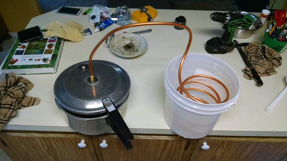

You can make a still with a pressure canner and some misc plumbing. For example:
http://www.instructables.com/id/Build-a-Lab-Qualty-Distillation-Apparatus/
If you have an electric stove, that would be better than gas. Expect it to take 4-6 hours for the first time. After various trials, I don't bother unless I have 2-3 hr to spare.
Although you can always buy essential oils, it's always more fun to make your own!

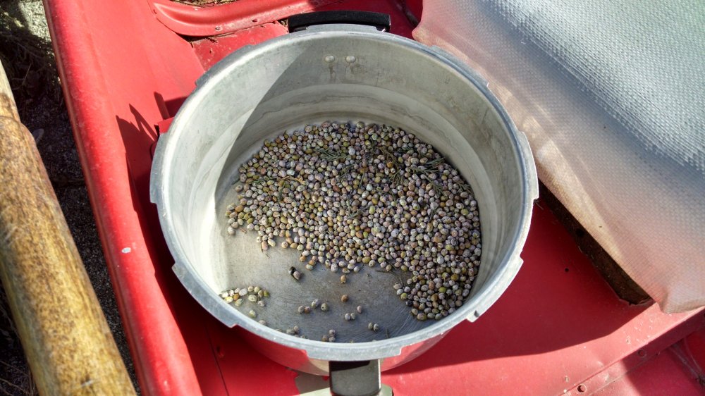

258 Pots
I have an old pressure cooker I installed a worm and a cooling bucket. I am in the process of gathering juniper berries, then will dry, crush and steam
distill, from what i've been told will be water and juniper oil. Then skim the oil off the water...
