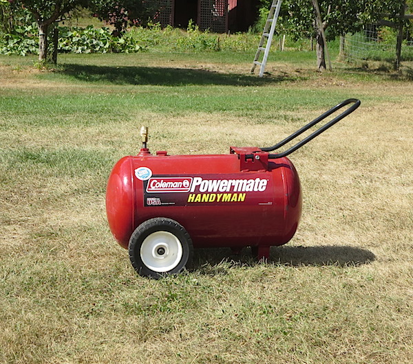

One day I went to the closest recycling place, nearby but much smaller than our “transfer station” (regional-district dump for our section of our valley and the village contained in it). The place I went is just a parking area with five bins. Though they’re not supposed to, some people leave miscellaneous junk on the ground—children’s clothes and toys, old VHS videos, empty beer & pop cans, that sort of stuff. I found that someone had left this 11-gallon compressor tank with the compressor itself removed.

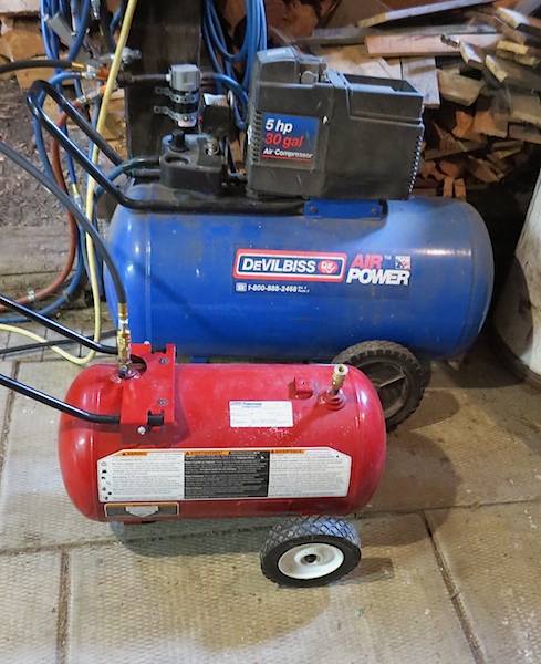

I looked it over, it seemed to have no cracks or rust where air might leak and it had good wheels & handle, so I took an interest… even though it was just a tank with a check-valve. I brought it home. I figured if I could get air into it, and out of it when I needed to, that I could use it as a portable to run my tacker from. The tacker drives staples or smallish nails, so I use it for things like shingling or tacking-on asphalt sheet roofing. I have a compressor, but it’s too heavy & bulky to take to sites, and is now permanently set up in my shop area.
I bought a few brass fittings intended to let air in from my shop compressor and allow me the outflow option to hook up pneumatic lines to my tacker or other tools.

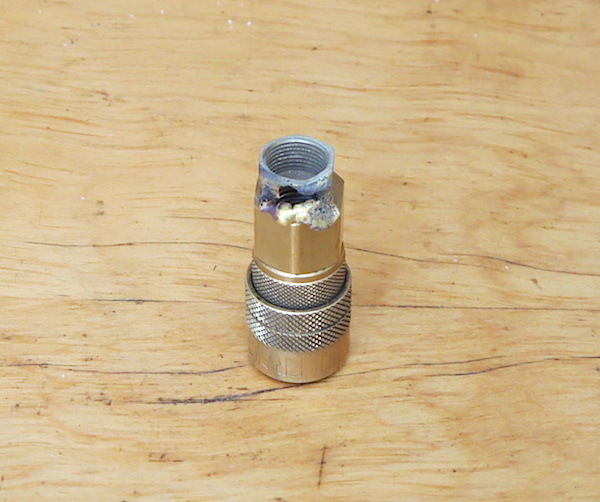

You can see one fitting in-place on top of the tank, above the wheel area. I tried to braze an adapter onto a coupler so I could use the tank’s check-valve to input the compressed air. The other picture shows the dismal result: using the smallest oxy-acetylene torch tip I own, I still managed to melt the adaptor before I could fuse the two parts together with brass filler rod. Oops!
My next move will be to have a neighbour of mine—who does brass (musical) instrument repair—teach me how to do lower temperature silver soldering to join an adaptor to the coupler. Repairing trumpets, saxophones, and flutes is delicate work. I suspect he may use a small butane torch for that sort of thing, but we’ll see.
