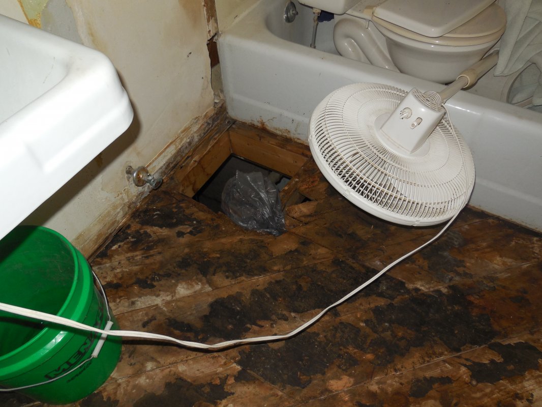

First thing out, after shutting off the water was the stool. Then son tore out the vinyl and the 3/4 plywood flooring under it to find a soggy mess around the stool. End of day one. The subfloor needed time to dry out so we set a fan to blow on the area and left.

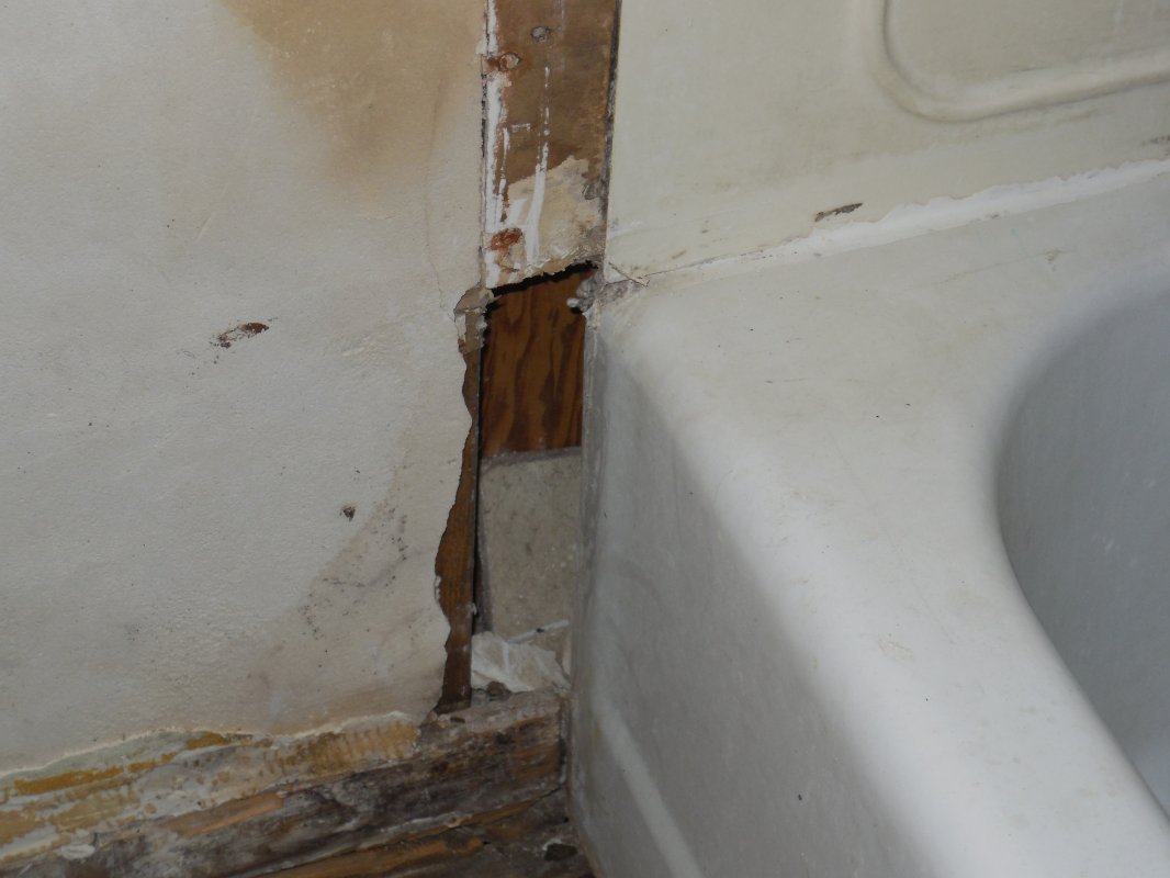

It wasn't in our plans to touch the wall behind the stool, but hubby had it half way off before son saw what he was doing. I guess it was for the best as the wall beside the tub was also wet where there is now a hole in the wall to repair.

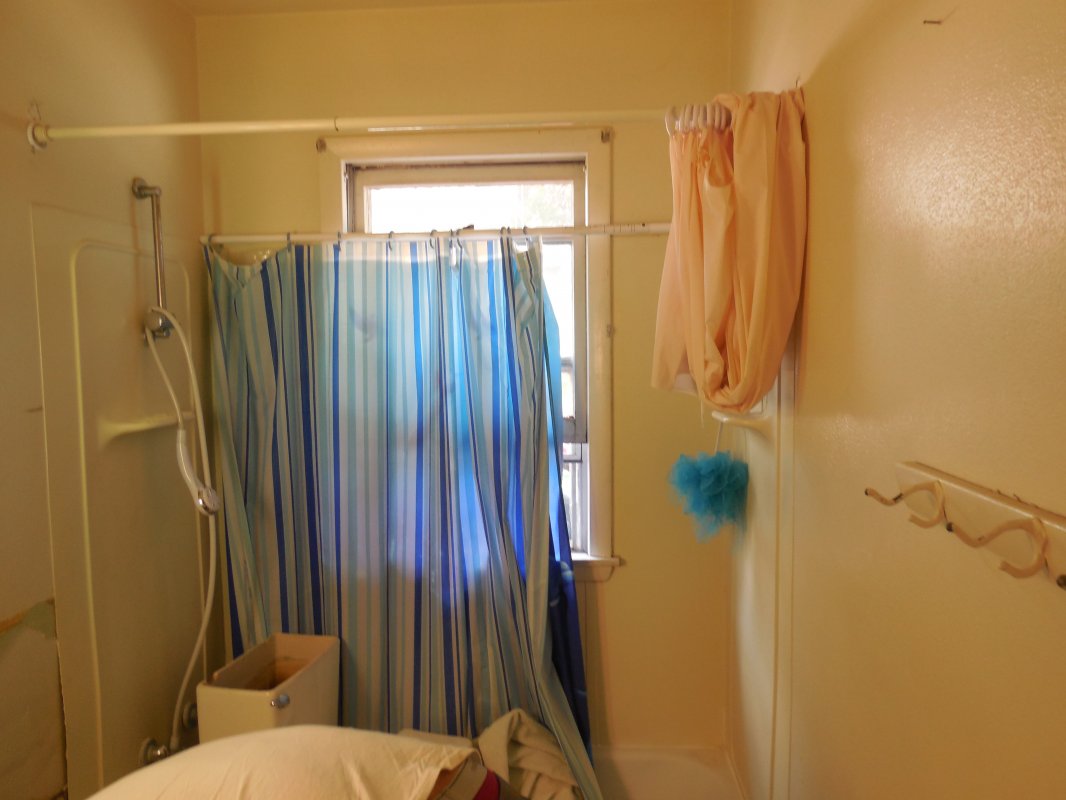

It seems that everyone wants a shower. I allow the hand shower attachment only if they keep the second shower curtain as a window covering. So far in the two apartments here with windows we have had no problems with the window trim.

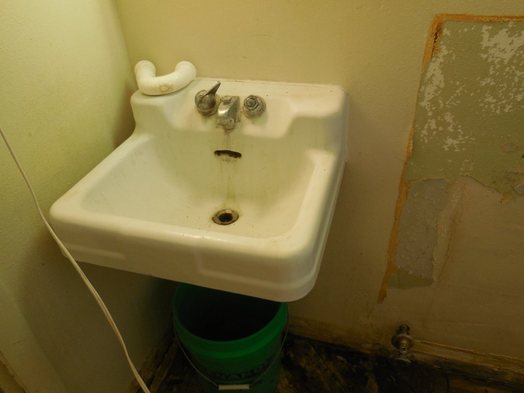

Here's the 1956 wall mount sink. I believe this is the last we will have replaced in the four unit building. I've checked. I can sell the faucet for $50 to a dealer in "restorations". The sink(s) he said he would love to get, but shipping costs East make it unaffordable.

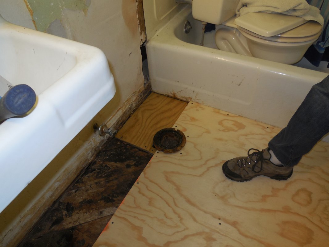

bathrm repaired subfloor around stool:new floor.JPG
As I said, I have to be fast. DH and I went to buy some supplies and the new vanity/sink. Son had the subfloor repaired and most of the new plywood in place. When we left son was filling the screw holes to make the plywood base smooth for the new flooring. I hope to get an after photo tomorrow.

Just an observation of regional differences: Here in SE Missouri I just don't see windows over bath tubs. Rarely even windows in the bath room at all. (Well, admittedly, I haven't seen all that many bathrooms in residences, but still...)
My brother in the Pacific NW has always had bathtub windows in the houses he has had. I think it must have something to do with the humidity issue, and the age of the house. Oh, and he doesn't have central air, so that may be a reason. I don't know. @Smart Red , what do you think the reason is? If any?
Smart Red
Jan 10, 2012
329
47
93
Wisconsin
Many reasons for bathtub windows. Usually it has to do with being an old house with an added or remodeled bathroom. Ya gotta use the space you have and that often means the tub goes under a window.
The older homes that have windowless bathrooms are also often added -- using spaces under stairways or closets -- whatever works and where access to installing water pipes might be easiest. Things are better now that cast iron drain pipes are history in new building or remodeling and the advent of pex piping for water. As spouse once said -- much to his regret -- you can do anything with plastic pipes.
One of our buildings has windows over the tub in the two outside apartments. As it was built as apartments in the mid 1950s, I'm sure the windows were intended more for ventilation than the view in an otherwise steamy room, however, since it was built, tubs are out of fasion and tenants want showers, hence my requirement for shower curtains over the window area. The two inside apartments have fan venting. Personally, I'd rather all the bathrooms there had fan vents.
