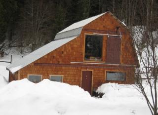

I had to look up that Bostich model because I've never used it. I shingled a barn that I remodled into a studio/shop on my place. Lots of cedar shingles! I used a compressor-driven pneumatic stapler.
The staples I used were probably always 3/4 to 1 inch long. The building was sheathed with plywood that was anywhere from 5/8" to 3/4" (I had used what I had around the place in order to sheath it).
Looks like the Bostich you have cannot shoot staples. So, if you use the Bostitich RN46-1, you'd probably want to use 3/4 to 1 inch nails, probably no longer. Seems like the RN46-1 can use ones of that length.

Hmmm... I'm not sure what sort of shingles you're going to use. Remember that you have to fasten (nail, or staple) the shingles up above the "exposure" portion of the shingle - that's where, with a taper-sawn shingle, you're into the thinner part. When I was shingling, that portion was never much more than 1/4" thick, and sometimes closer to 1/8" thick.
I'd still think about using 1-inch nails, but of course you gotta use your own judgement.
Happy shingling. It's a time-consuming job, but looks nice in the end and sheds water well, if that's also a consideration.
619
You can keep the snow! (But, I still like the barn.)
