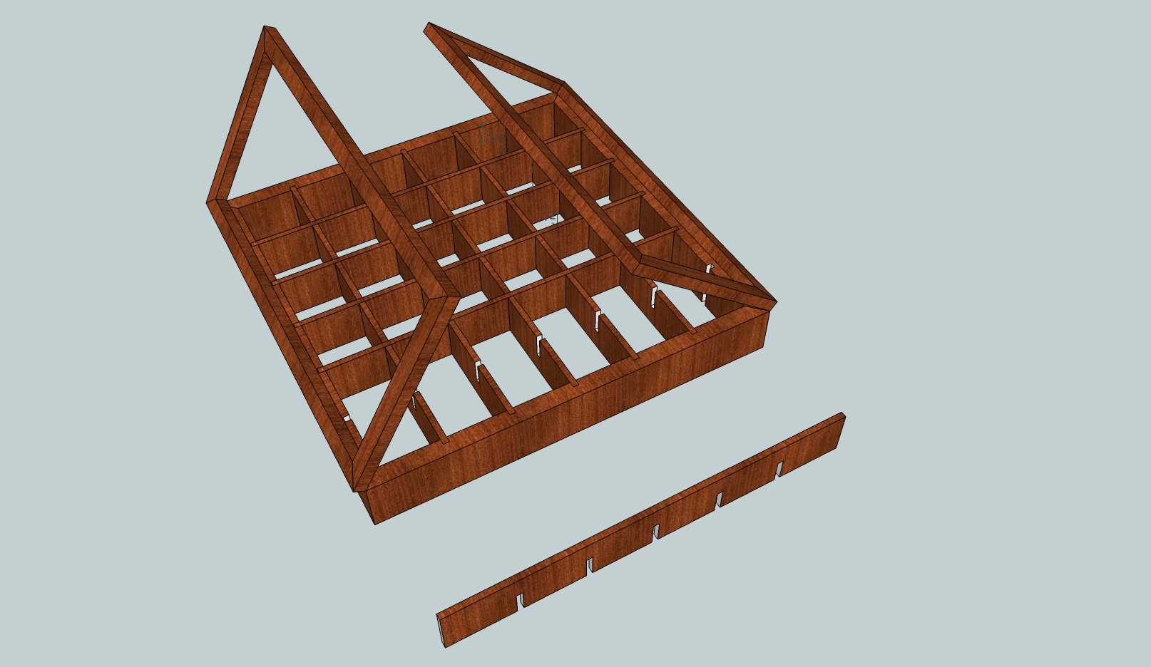

I drew this recentley and I'm have some questions about the deign. I can't decide whether to glue the cross peices or let them float int he grooves. Anyone built anything similar?

What is the material, and the purpose of that it serves. If the notches ar a real tight fit glue wouldn't be good, because the glue would scrape off. If the notches are too loose then it will rack. As long as the notches align well and go together smoothly at the dry fit stage it probably wouldn't matter. If it critical that when used that nothing shifts with age or use, then glue is defiately needed. Use a glue that has a long open time, and use clamping squares to hold things together. And most important is build in a a dead flat surface.
Hope this helps.

This looks like a planter box, miniature hot house.
