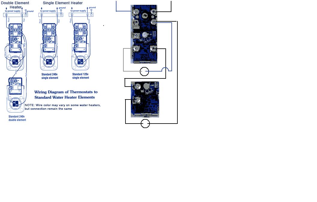

Many of you know how confusing a water heater's wiring seems to be. After all you have two elements, each capable of 4500 watts when operating drawing about 27 amps of power. The thing is they don't operate at the same time!
Check out this diagram.....

Weird, I just assumed the operated at the same time!

for single elements it doesn't present a problem but put another element into the mix and the amperage is doubled if both elements come on. a 4500 watt element draws 18.75 amps when it starts. 4500 divided by 240 = 18.75.
most heaters are wired in the sequencial start configuration. on a cold start, the upper element kicks in first. when it's satisfied its thermostat switches to the lower element. when that is satisfied the whole unit shuts down. NOW, when you draw hot water, you are removing water from the top of the heater and forcing the cold water down to the bottom where the lower stat is. Draw off enough hot water and the lower element kicks in to try to keep up with demand. If you pretty much empty the tank, the upper element turns on and the sequence begins again.
