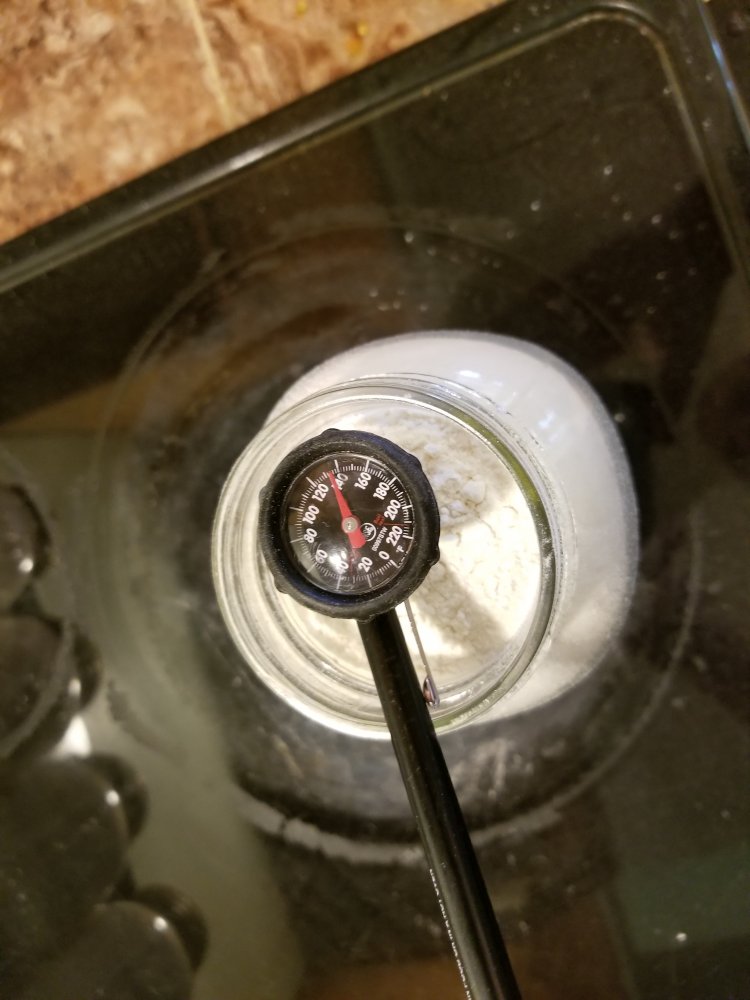

usually I store flour in Mylar bags with o2 absorbers in the freezer. it lasts for EVER and I don't have to worry about weevils. unfortunately we got some flour in 10 lb bags and they won't fit in Mylar bags and the freezer is nearly full so I had to come up with something else to kill weevil eggs before they hatch and keep the flour safe. so dry canning came to mind.
I looked on the web and it seems everyone is canning at 200-250°f for an hour for quarts. Google says weevil eggs/larvae die at 140°f after 15mins .
2,807
4,885
287

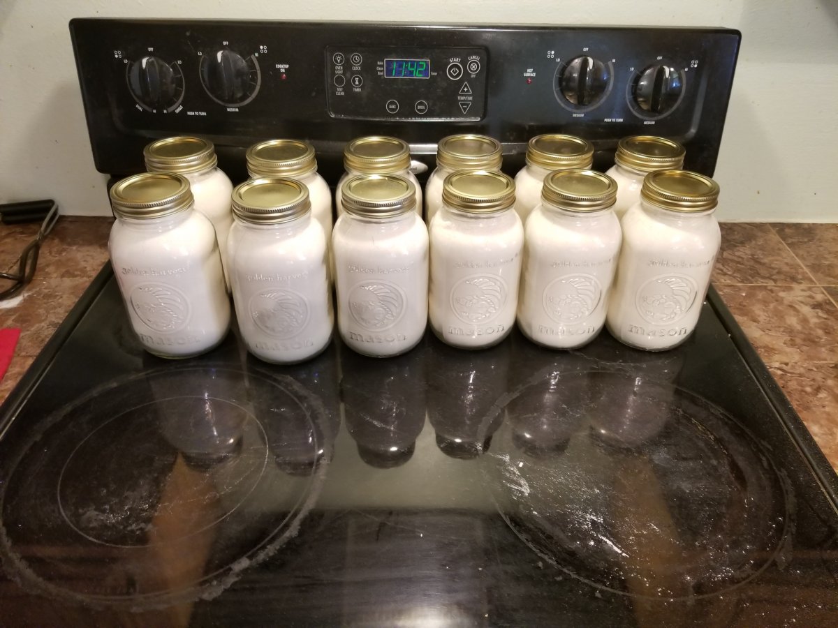

so i figured I would go in the middle and set the over at 225°f. just like when I use it to sterilize jars. I washed the jars, and then ran them I the oven to sterilize for 45 mins. it also dried them. I boiled the lids and set them out to dry. packed the jars and made sure the flour had settled by smacking them on the counter top. head space was between 1 and 1/2 inch. put them in the oven for an hour and checked temp. it was only 120°f. so i let them go for another half hour and they were all about 140°.
after they reached 140 I wiped the rims with a damp rag and put the lids on. they all sealed.
