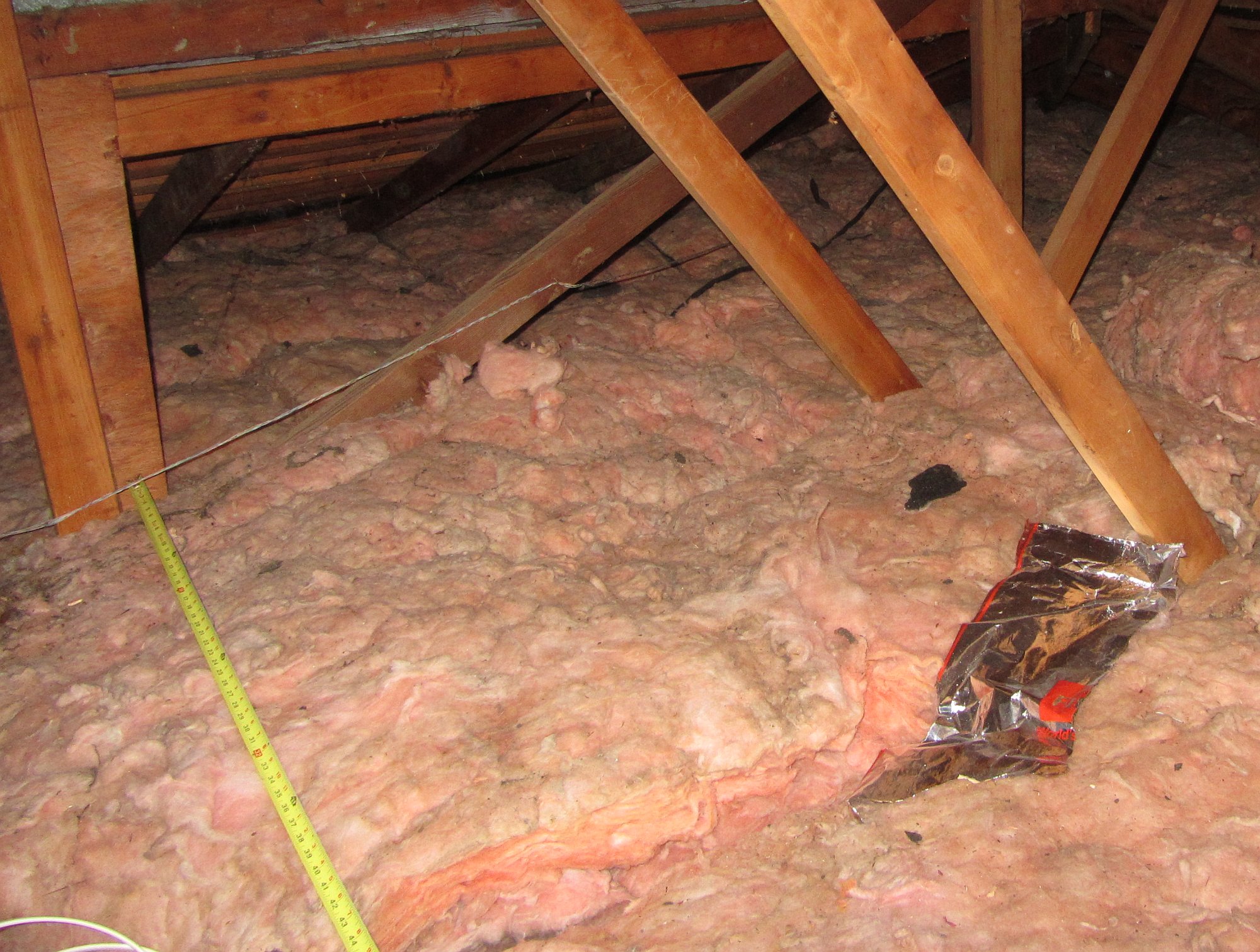

HayZee, you're timing here is EXCELLENT! I'm in the process of creating a new office and want to add canned lighting, but I worry I may not have enough crawl space in the attic to do the wiring.
Here's a picture of the space I'm working in. Unfortunately I need to put cans in the space that is past the end of the tape on the left, which you can see gets pretty tight.

That looks pretty roomy compared to some attics I've seen. Wear long sleeves, or that fiberglass will have you itching forever.
If that black stuff in the background
is old romex wire, it should be installed in drilled holes in the joists, not laid on top of them.​
