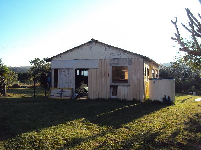

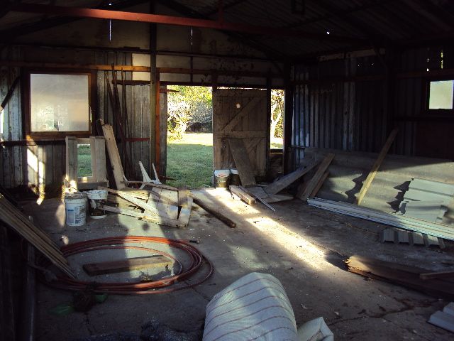

We have a bit of a mess on the farm that we refer to as "the barn". No-one knows what it's original purpose was. It's in complete state, but looks structurally safe and has, in our minds, lots of potential for a small 1 or 2 bed dwelling. Here's what we've got:
The building measures (very approximately) 24ft x 18ft, which doesn't give us a heck of a lot of space to work with, so we're thinking open plan kitchen/living area.

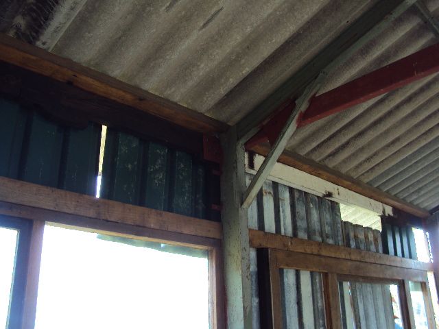

That back area, where the toilet is, will most likely be the bedroom(s). I would like to squeeze 2 bedrooms in there with the bathroom on the right, forming an L. Which means the little bathroom windows in the left would end up in the lounge/kitchen and the huge window in the bathroom. Existing plumbing arrangements... :rolleyes:

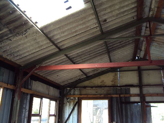

We have some very nice, huge wood framed glass doors which we can replace that old door with (I know! It's gorgeous, but it's falling to pieces). We're still undecided on where exactly to put the kitchen, but we're leaning towards the lefthand side where the big square window is. The bathroom will be squeezed in-between the kitchen and the bedroom, more or less where the coiled red pipe is.

If your looking at the improvements being inspected by an city or county building inspector, your going to be in difficulty. the structure itself as it stands right now is not safe, I know I know your saying...well it's still standing now !! Unfortunately building inspectors don't take that into consideration (nor should you) if it were to fall down a barn with tools in it is much less of a worry than people in it.
There are so many areas at issue from structural, lack of studs, headers over windows, distance between the trusses <<<< that's a biggie and not an easy fix, then add in the floor.
Have you thought how you plan to address the issues of plumbing and how and where your going to run the waste lines ?
Renting out a property that doesn't meet codes (all codes including electrical, plumbing, fire and structural, even toss in insulation) is a liability nightmare, thinking about that, the owner of the property would be liable for you and your family should he/she allow you live (even rent free) in a none approved premises.
It's a very slippery slope, make sure you do your homework.

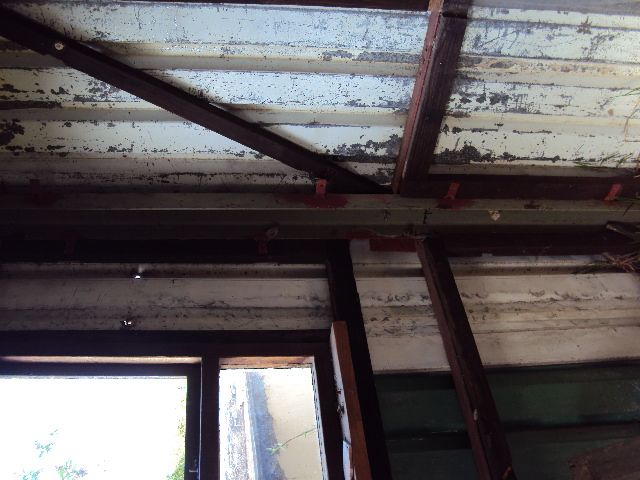

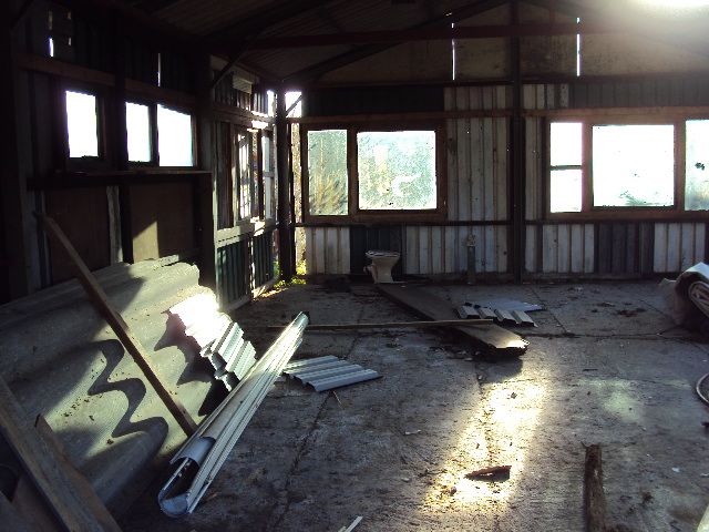

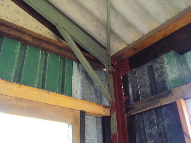

Is the structure basically a steel framed building with purlins along the walls? Because I don't see any studs as in a conventional building. AND the floor looks like crumbling osb siding. Is there a concrete slab underneath all that osb? What do you have for a waste system? And what about water? Well? How about heating?
Don't worry, we are aware of the building laws, requirements, planning etc and what we can/cannot do. Since we live in Africa it's a delightfully grey area. I am going to leave it to the landowner to sort out though, while DH and I sort out the what-do-we-need-to-do-to-make-this-place-habitable bits. The building does need a lot of cleaning up as it looks much worse than it is at the moment, but I am realistic. We're going to to have to do quite a lot of work here.
It is a welded steel and wood (mostly steel) structure and is quite solid. It was the first thing we looked at when we started thinking about converting it. There is now way I'm moving into a building that is not safe! The "walls" are a bit flimsy though and we're going to have to put a lot of work and money into them. We are going to fit panelling along the walls on the inside and replace some of the boards and sheets on the outside, where needed.
Here are some details of the frame:

The floor is concrete and also in a good condition, no damp or cracks.
Plumbing wise we have a plan in place, but the septic tank arrangements, which is already in place, is on one side of the building, so we are going to have to put the bathroom and kitchen on the side where it will be the easiest and cheapest to run the outlet pipes. The landowner is friends with an electrician who sorted the electricity out in the other outbuildings and he already gave us quite a reasonable quote for putting electricity into this building.
Our climate is very mild, so insulation and heating will not be needed. We might put some light insulation in when we put a ceiling in, but we're still undecided on that.
