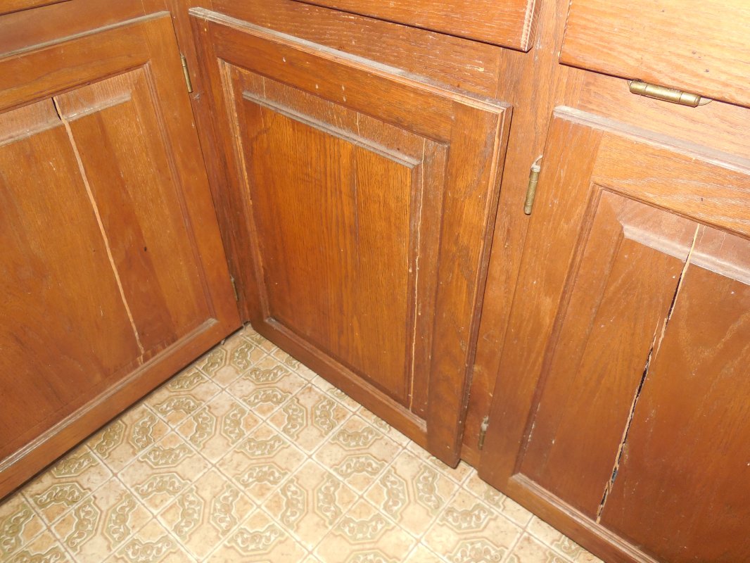

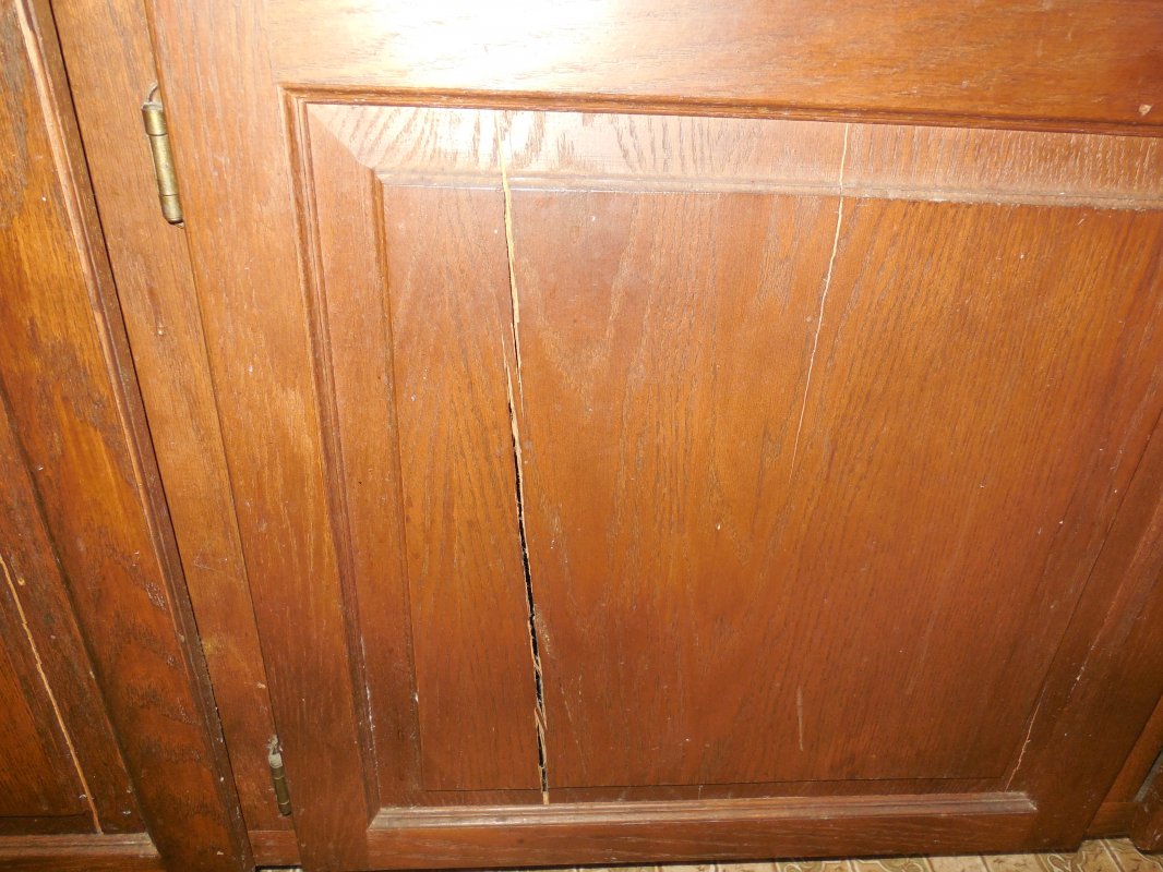

One final thing that needs to be done is to make new doors for the lower cabinets. We glued the panels to the rest of the doors and they all cracked. While the doors look great during the summer, having the heat on causes the cracks to show every winter. Unless. . . unless the new heating system which will include both a HEPA air cleaner and a whole house humidifier will keep the doors from drying out. I guess I will wait and see.

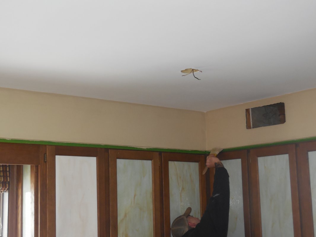

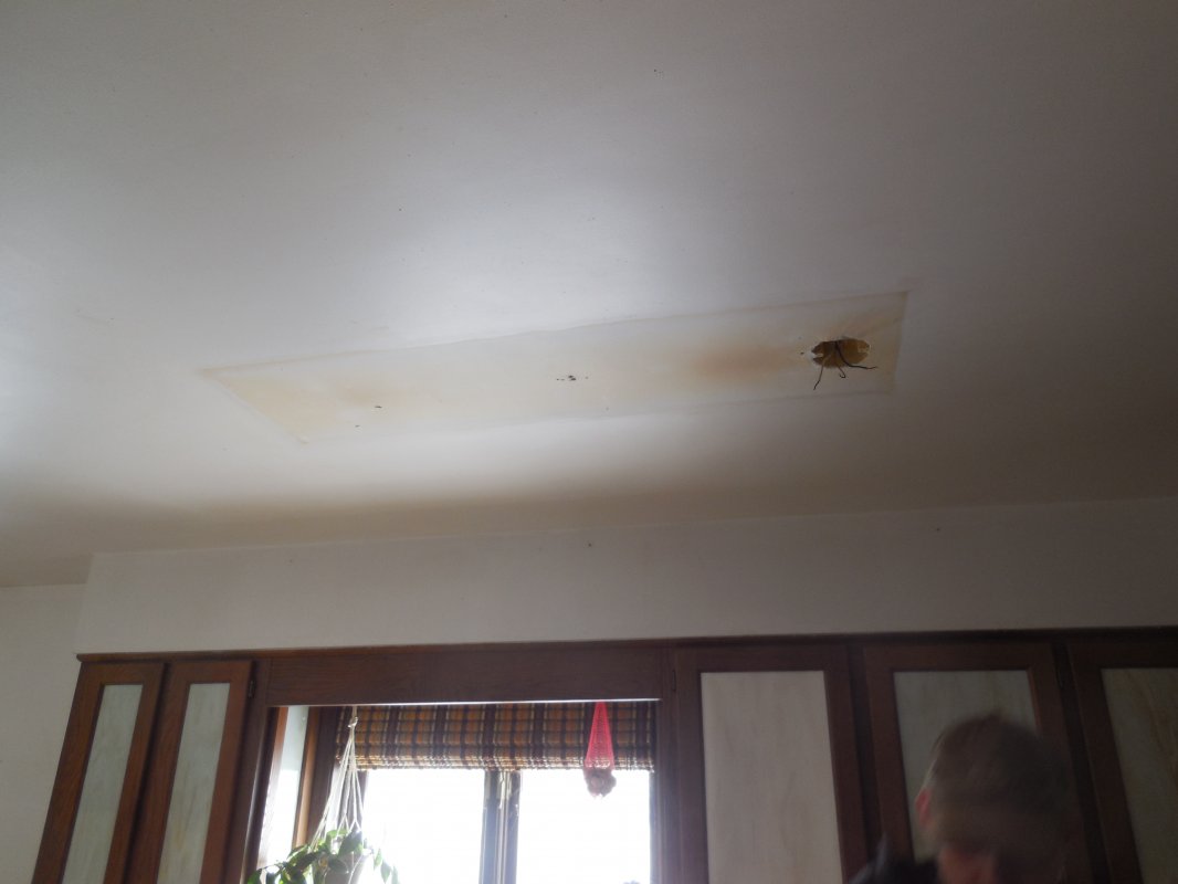

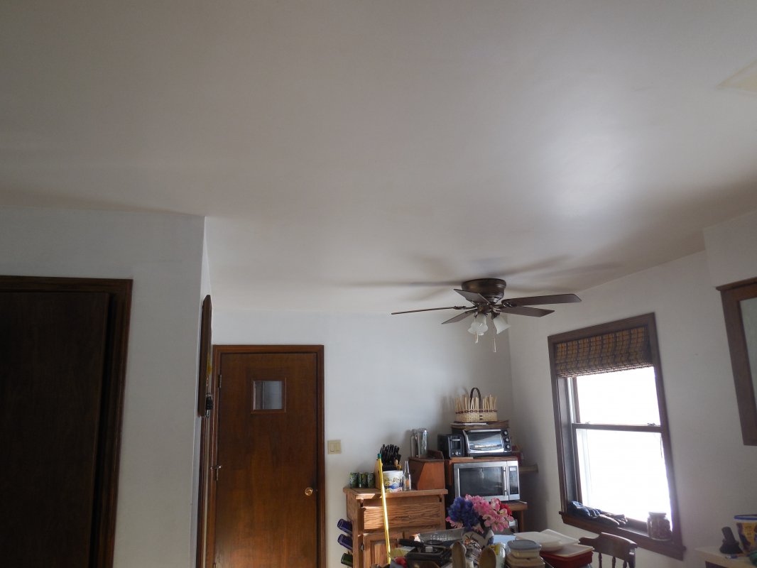

On Sunday, DS painted the kitchen ceiling. I forgot to say anything and ended up with a flat ceiling paint rather than the semi-gloss I had before. It was a paint that went on slightly purple and dried white. Here is the kitchen before painting.

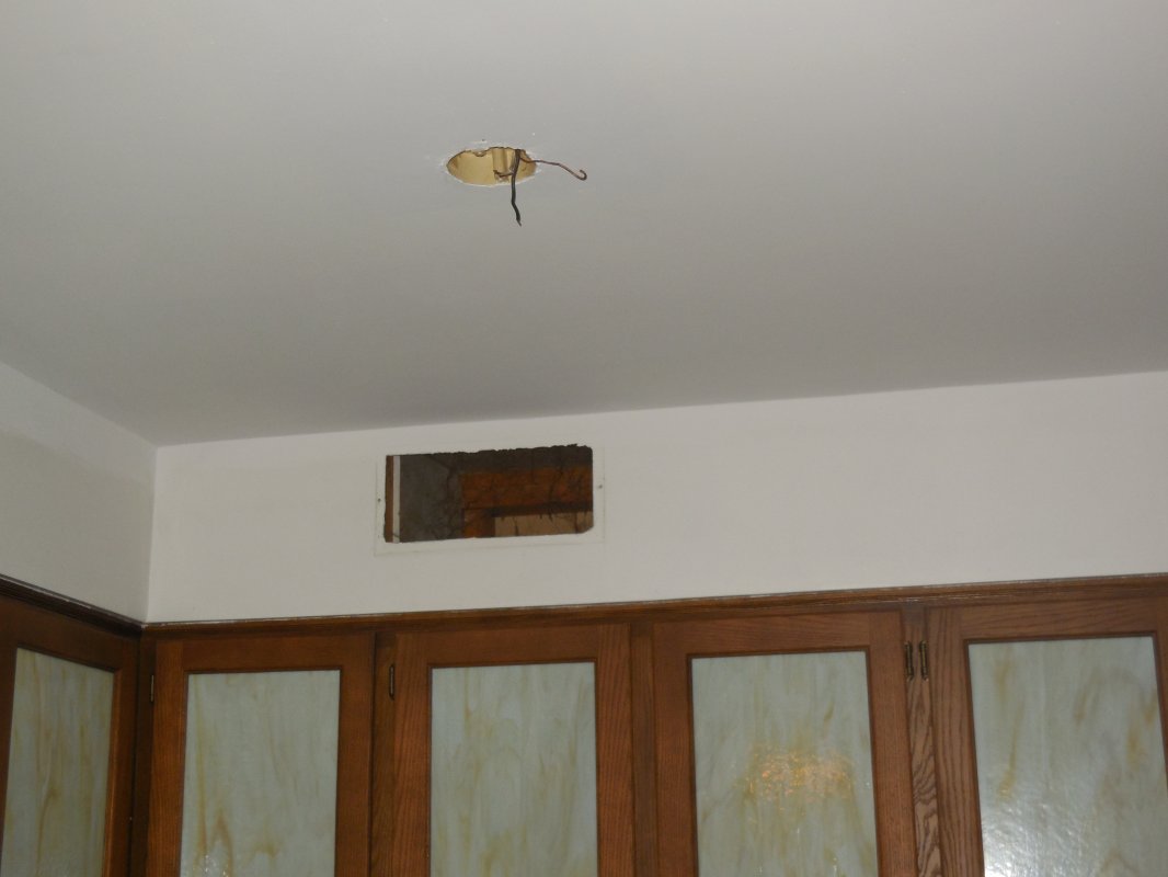

He also took down the 4 ft. florescent light fixture.
I am happy that I decided to up-date the light fixture. When it was removed there were signs of overheating on the ceiling and one of the wires was burned slightly. It could have been just fine, but it could also have been a house fire waiting to happen.
Here is the finished ceiling painted -- and now dried white -- with the flat 'purple' paint.

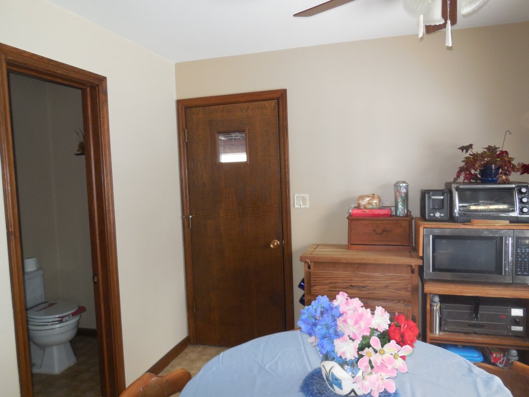

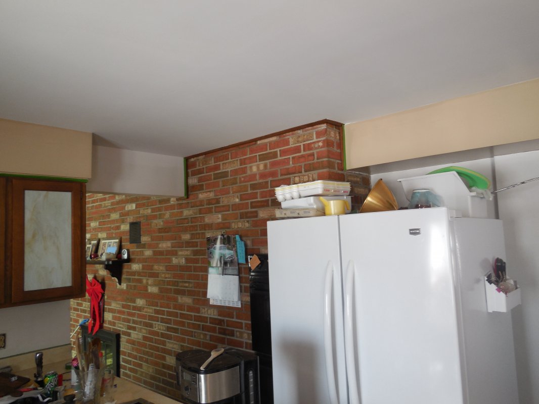

On Monday, DS painted the darker of my color choices -- Brown Owl -- on the back wall and all the bulkheads. Brown Owl is the same color that is in my small bathroom by the kitchen/back door.
As you can see, my color scheme has been pretty boring. Except for this brick wall and the one in the living room, most of the house is some shade of white. This is a big change for me. I can hardly wait to see how the two colors work together. . . if they work together.

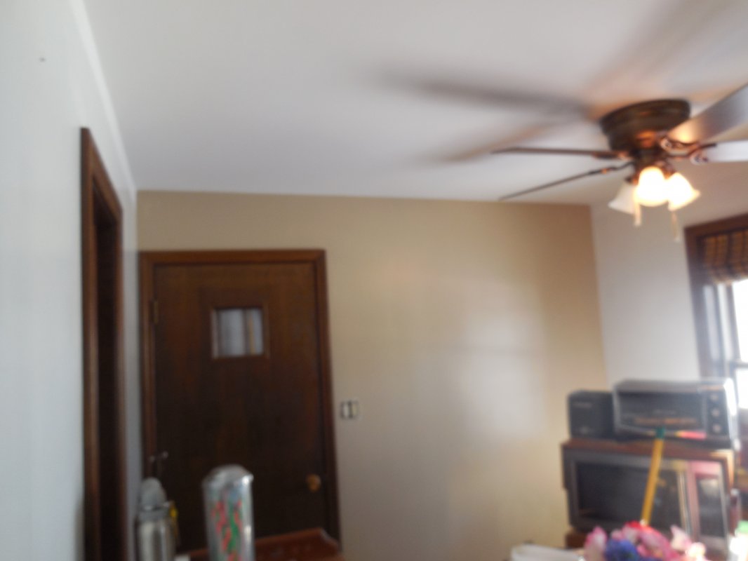

Here is the finished back wall. It doesn't show much darker than the rest of the walls, but there is a difference.

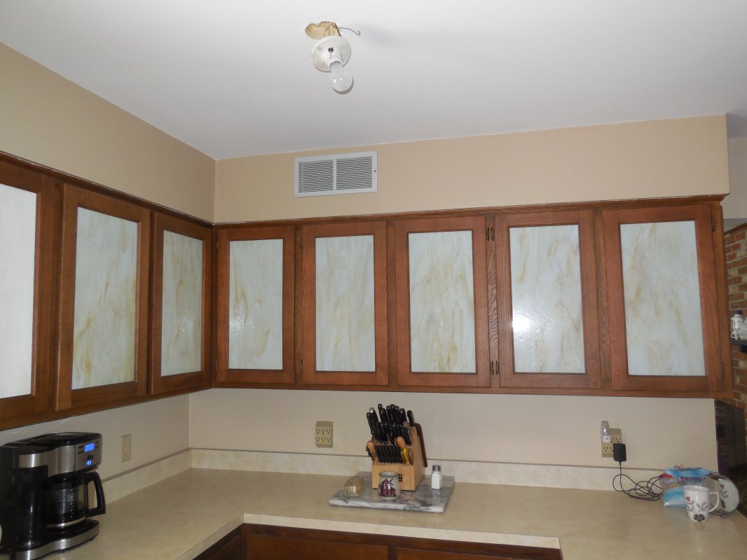

Most everything is put away in its new place in the newly cleaned and restructured cupboard spaces. The kitchen light fixture -- DS stuck up a porcelain with light just until I find the perfect new fixture.
All that really matters is that I like the job now that it is done. And I certainly do!

Please excuse the "finished back wall" photo. I should have closed the mini-bathroom door. Since I have a "new" bathroom, I decided it needed a new toilet seat and paper roll holder -- still to be installed.

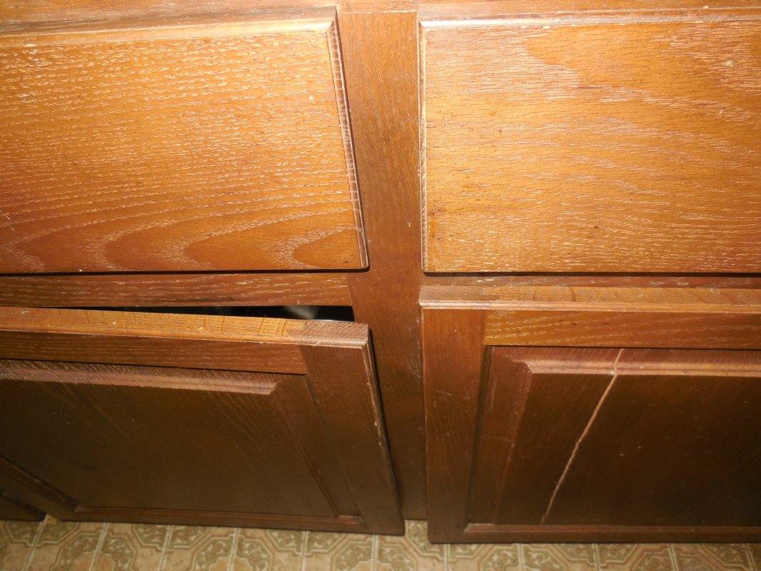

Here are some photos of the lower cabinet doors. Some are warped because of being glued and other have long cracks
Here we have warping and cracking.
And these below are all cracked somewhere on the panels. Come summer and these cracks are almost invisible.
These photos were taken before I got the cabinets washed down. The drips and scratches have been cleaned and touched up with stain.
