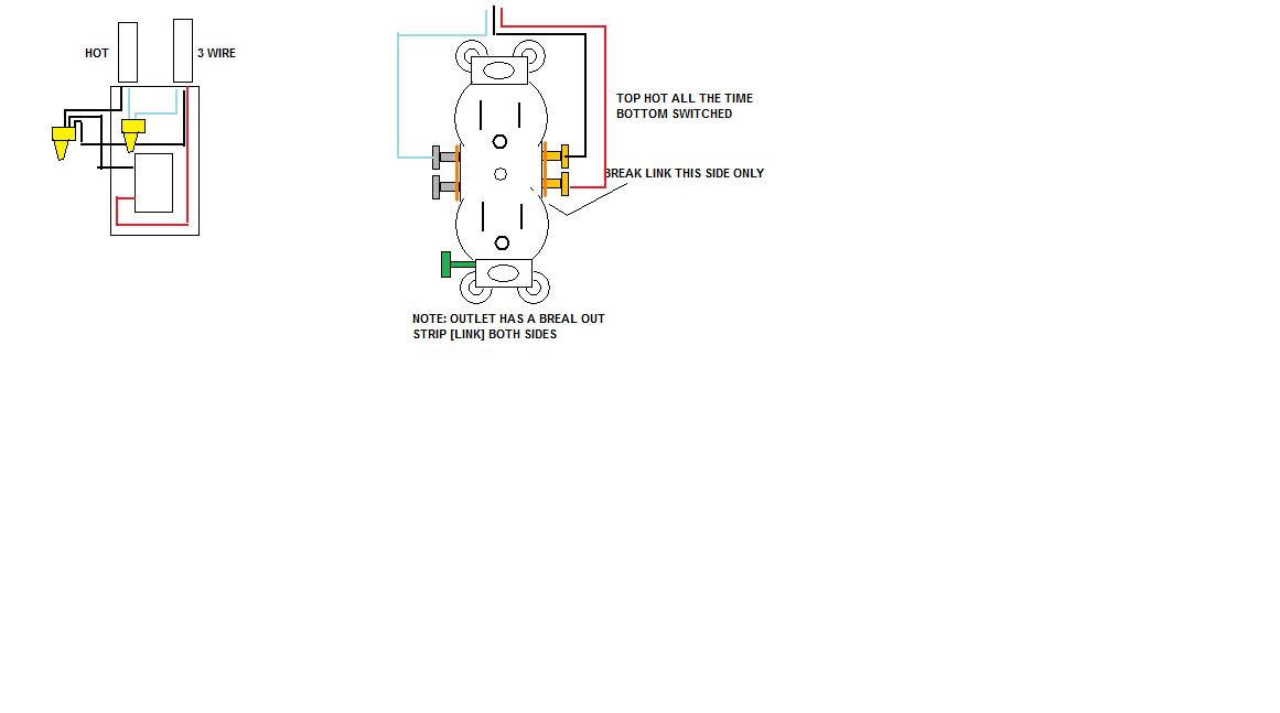

Sep 30, 2013 #1 HayZee518 New Member Joined Sep 11, 2013 Messages 66 Reaction score 1 Points 0 Location Saint Regis Falls NY The following diagram shows how to wire a split wired outlet where the upper half is hot always and the bottom is switched, in lieu of a room light. Attachments SP-3W.jpg 32.9 KB · Views: 730
