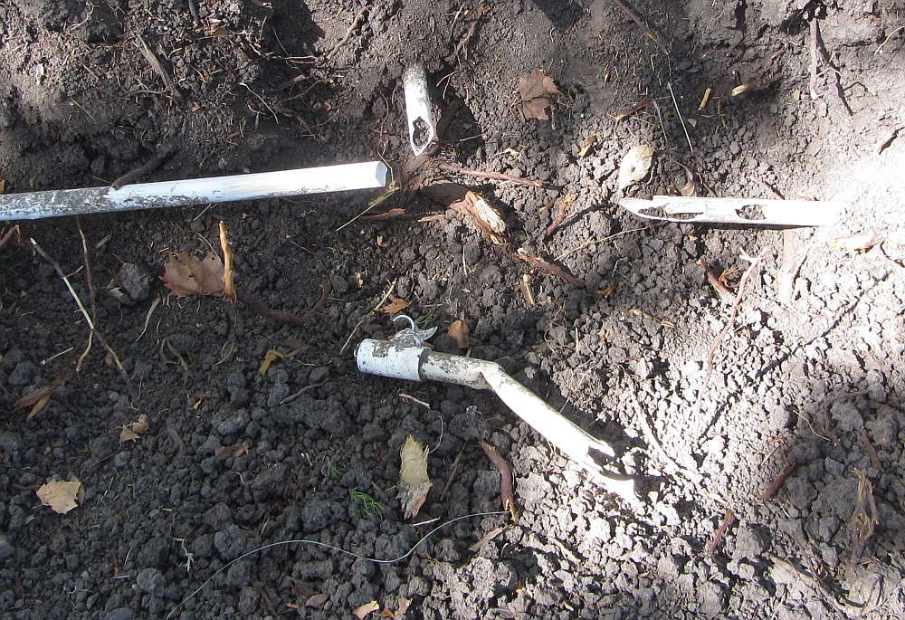

Unfortunately the roots ran right through a T in our sprinkler line and up it all came with the tree roots.

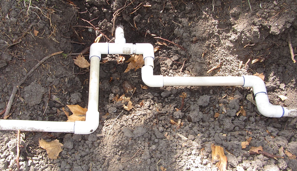

So, I spend a ton of time yesterday digging out the broken pieces and putting everything back together.
You'll notice in one of the pics that I used WAY more elbows than was needed. We've actually had those sitting around in a bucket for about 9 years and I was about to give them all away. Glad I didn't. It was a little more work to use them instead of straight connectors, but hey, I didn't have to make a trip to the store or buy any new fittings!

Destruction from tractor / roots:
New pipes using up old elbows

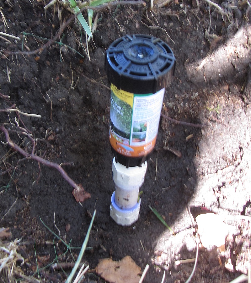

Tractor also ran over a sprinkler riser so that had to be fixed too:
I don't know about your pvc splicing with all those elbows. Do you know at every ninety degree elbow there is a pressure drop? It may have been better if you spent the extra cash and bought two couplings.
Yup, I got that covered. We've got tons of pressure and the diameter of the supply lines is actually bigger than what we need... in fact they are reduced right before they go to the sprinklers.
Also, the heads are adjustable and I've always had way more pressure than needed and have always had to crank down the volume coming out of the heads, so I knew I had a lot of margin to play with.
