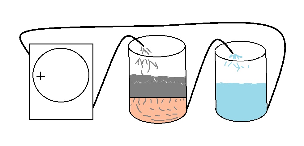

Okay, I'm not an animator, so be patient!
But something like this, the washer pumps out the water down the barrel with sand filter - the water is purified and go on to the barrel to clean gray water, and from there the water goes into the washing machine.
I need to have a pump between the tub with clean water and the washing machine, but that's easily fixed because I have to start the generator to power the washing machine.
Neiklot
Nov 5, 2011
106
1
68
Sweden
Edit: The pump needs to sit in the hot tub with gray water.
The hose from the washing machine breaks down in the bottom and the water is purified on the way "up" in the barrel.

In other words, you need a motorized pump - and therefore you need energy input (electrial power) not only for the washing machine, but for that pump too.
Another way (and it would still need an energy input, but this could be a controlled flame/fire) would be to distill the wash water. Heat the water until it vaporizes (becomes steam), guide the steam to a condensing stage, and then capture the distilled water in a container, possibly a barrel. In other words, the first barrel could be used to collect the wash water, and then it would be heated in this barrel. The tubing coming out of the first barrel would guide the steam, and then condense it - and drip it into the second barrel. The second container or barrel would be where your purified water is collected.
You could stop the process while the dirty water container still has some liquid in it, which could be allowed to become a fairly thick liquid - and this could be drained off as the dirty liquid residue.
You'd be removing very dirty water from the cycle. Therefore, you'd need to input some new water into the whole cycle from time to time, to add to the distilled water.
