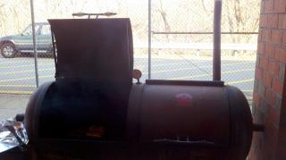

its made from an old compressor tank
the tongs are resting on the firebox it has removable grating and a removable rotisserie. fits about a 75lb hog

Very nice unit you made there. Thanks for posting about it.
