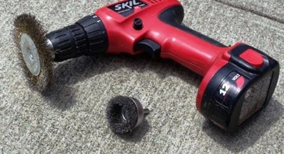

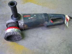

Yeah, I had the same experience. Someone brought me a couple of old cast-iron skillets to clean up. I have a sandblaster, and I tried it, but it worked unevenly. It was too slow where the encrusted old baked-on oils & fats were pretty thick.
So then I tried a wire brush. I've got a wire brush that fits on an angle grinder...
A lot of people who don't own an angle grinder have wire wheels or brushes (pretty cheap to invest in) that fit on an electric drill...
Anyhow, that worked well and quickly. I got down to clean cast iron. After that, then I washed them up like ordinary dishes and kitcheware. And then the owner gave them a good seasoning, and the pans looked and functioned just fine. :)
