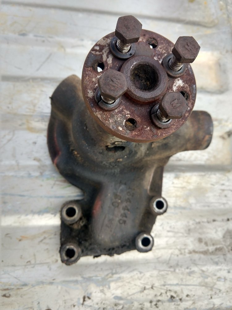

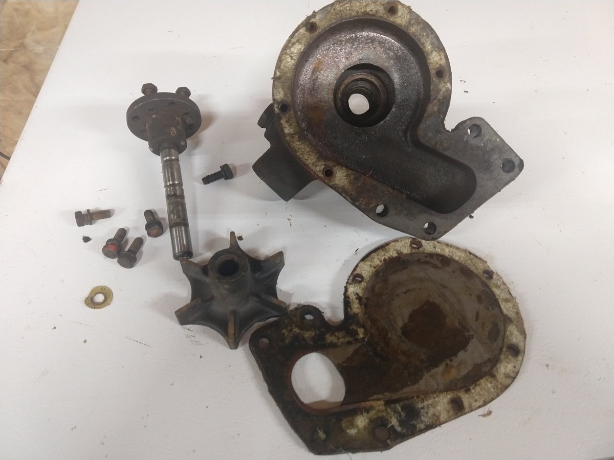

Well my son worked on the water pump and was able to press out the impeller. I was amazed how the guts of this water pump was put together and now I know why it failed. It's been a long time since I've see brass bearing races. If you notice the shaft it'self is the inner race for the ball bearings. In the second picture the slit in the housing is where you manually add oil. And you can also see, it's been a long time since the bearings in this pump have seen any oil, evidenced by the rust on the shaft in-between the two inner races on the shaft. I would say it's been a very very long time since the bearings seen any oil. I didn't know it's was supposed to be manually oiled or I would have oiled them. But now I know to oil the new pump, that's on order. Another really cool thing is the brass tag with a stamped number. I assume it's a serial number for the pump itself?
All I can say is this pump was built to last and even without any oil the bearings it lasted 59 years. We (made in USA, Wisconsin to be exact) really made some bullet proof stuff back in the early 60's. I have a personal moto "when in doubt, double the stout" but Allis Chalmers must have trippled the stout, back then. 👍
Now speaking in all honestly, if this pump would have been maintained as it should have, there would be absolutely no reason for it to fail. Live and Learn... I will always be learning, probably until death over takes me.

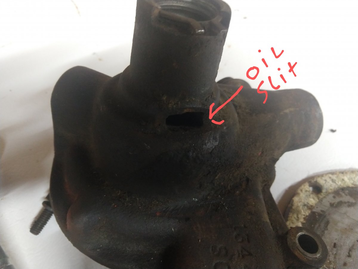

@farmerjan - I know you said you have a Allis Chalmers D series tractor, although I can't recall the number. But check for the oil slit in the base of the housing neck of the water pump and oil the bearings with 90 to 120wt periodically, if you didn't already know like me. Save yourself some grief and downtime.
A piece of ancient engineering on steroids. I mean seriously, who casts iron this thick for a engine water pump? Allis Chalmers in Wisconsin in the 1960's, that's who. Even the backplate is 3/16 inch thick plate steel, which is absolutely crazy.
Here's where thick oil should have went.
