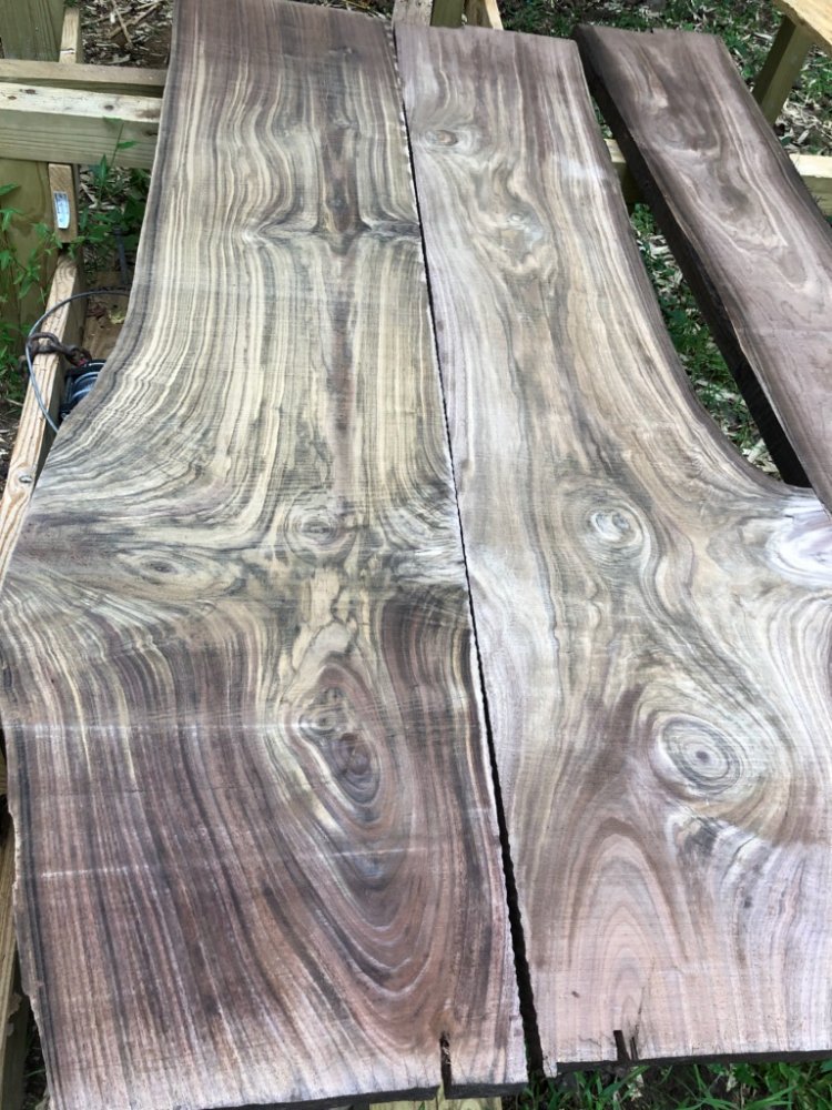

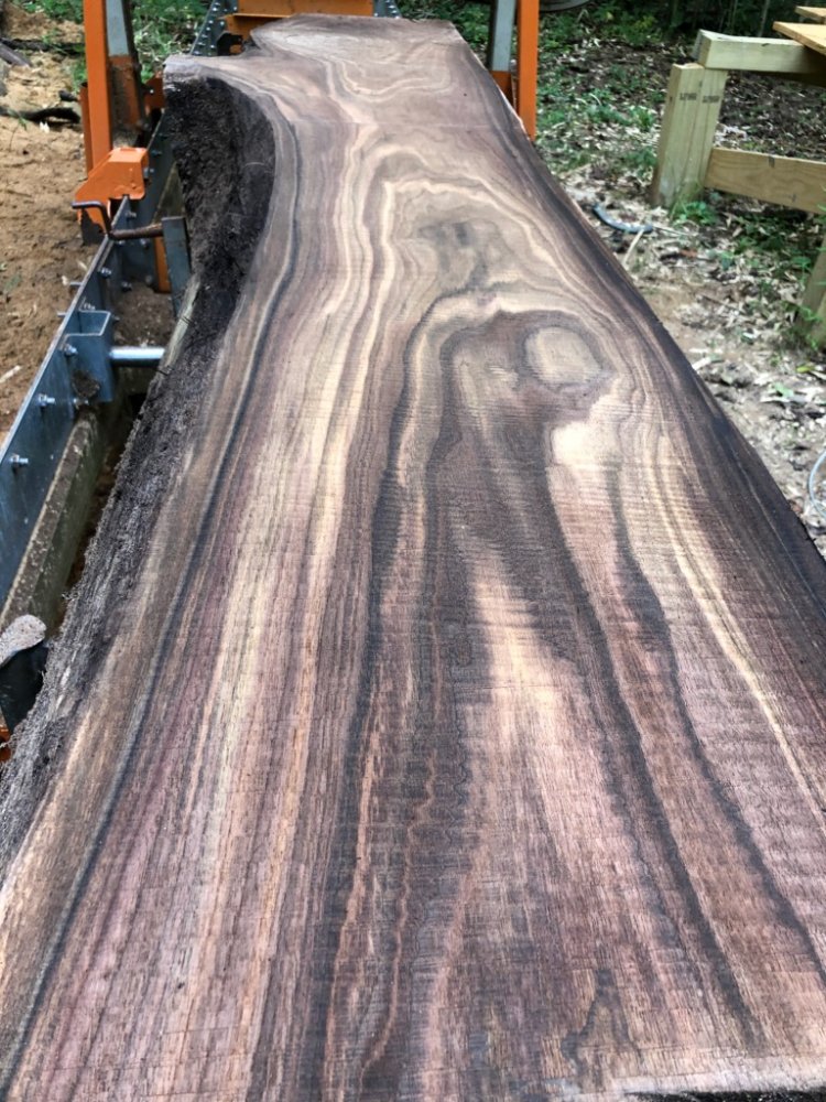

@CrealCritter - Getting back into this thread as we get back into working with our sawmill. Haven't been back through the thread, but do you have experience making cutting boards? We were extremely blessed with two big Black Walnut logs and we're making our cabin door, maybe a table or two, and hopefully a handful of cutting boards. I hear mineral oil is good to finish with, maybe a bit of beeswax added? We were finally able to invest in a planer so I am really stoked to see what comes of it. Also, the logs are so massive we are expecting to have leftovers even after that- any ideas for one or two inch thick pieces, not too wide? These monsters were over 20" wide in places, so we will have some excess when we cut it up to foot wide for it to fit in planer. Thought of putting some 1 inch up for maybe jewelry boxes?

It's very unusual for black walnut to show heartwood past the solid black line that separates heartwood from the creamy colored sap wood. Very nice looking Walnut you have there, I can almost smell it and it's making me itchy just looking at it from here.
Please be careful and try and not saw to much at one time and not very frequently. Sad to say you might end up like me and become allergic to it, and break out in itchy hives. I already know if I have walnut to saw, it's two Benadryl and a shower directly after I'm done. I'm only allergic to the green/wet wood and sawdust. I have no issues once it's dry and can woodwork it all day long, which is really odd.
Walnut always amazes me, every log is like unwrapping a Christmas present, nice work!

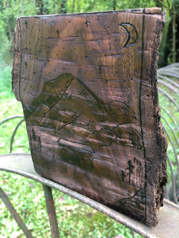

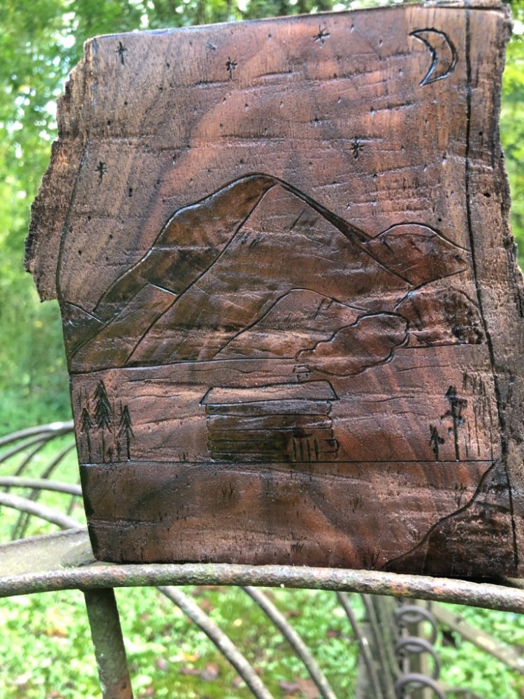

@CrealCritter - Luckily the logs sat and dried here with no issues and look good on the inside, so cutting them has been no issue as they're really dried out. It was a shame to know they had cut such a massive tree, but gratefully we plan to put it all to use. Even the outside pieces and parts of the knots we are cutting up for crafts. And yes, it is definitely like a present! We ran out of gas for the day when I posted so I can't wait to continue cutting into it more and see what the grain looks like.
This is just a small piece outside piece cut originally with the chainsaw mill. Sanded a little, woodburned freehand, and spray lacquered (turned it super dark) with intent to sell but I may just keep it :D
