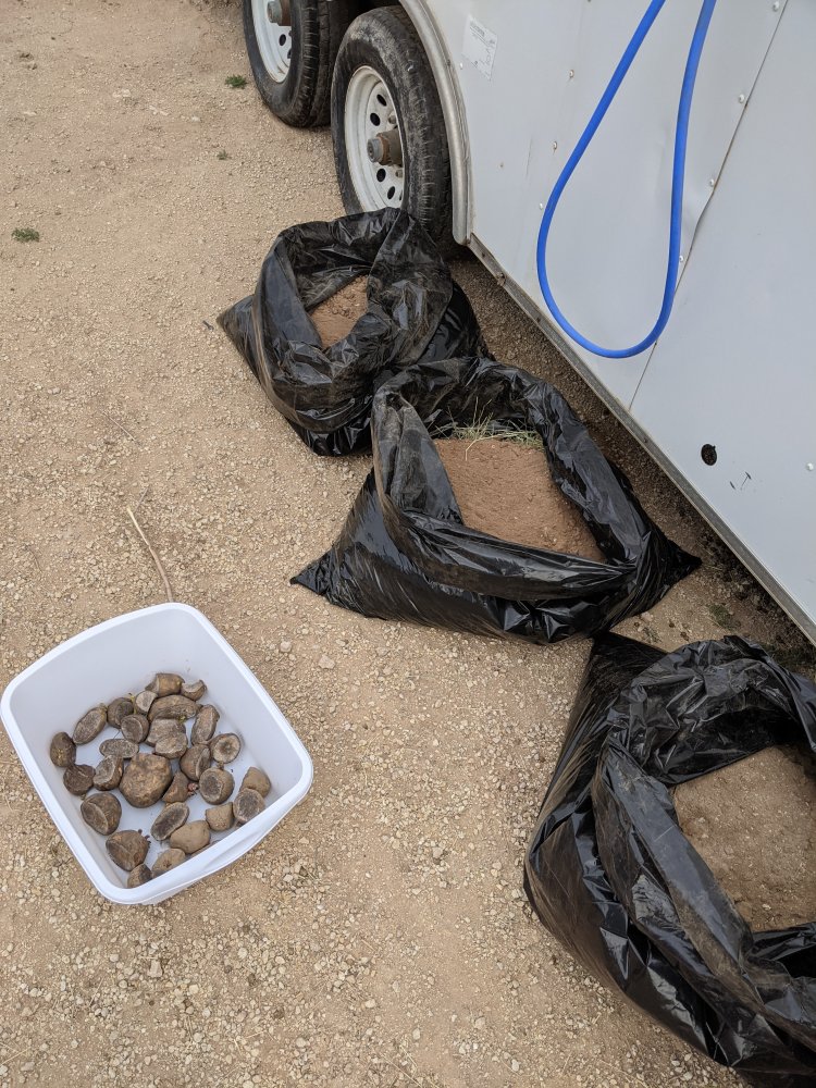

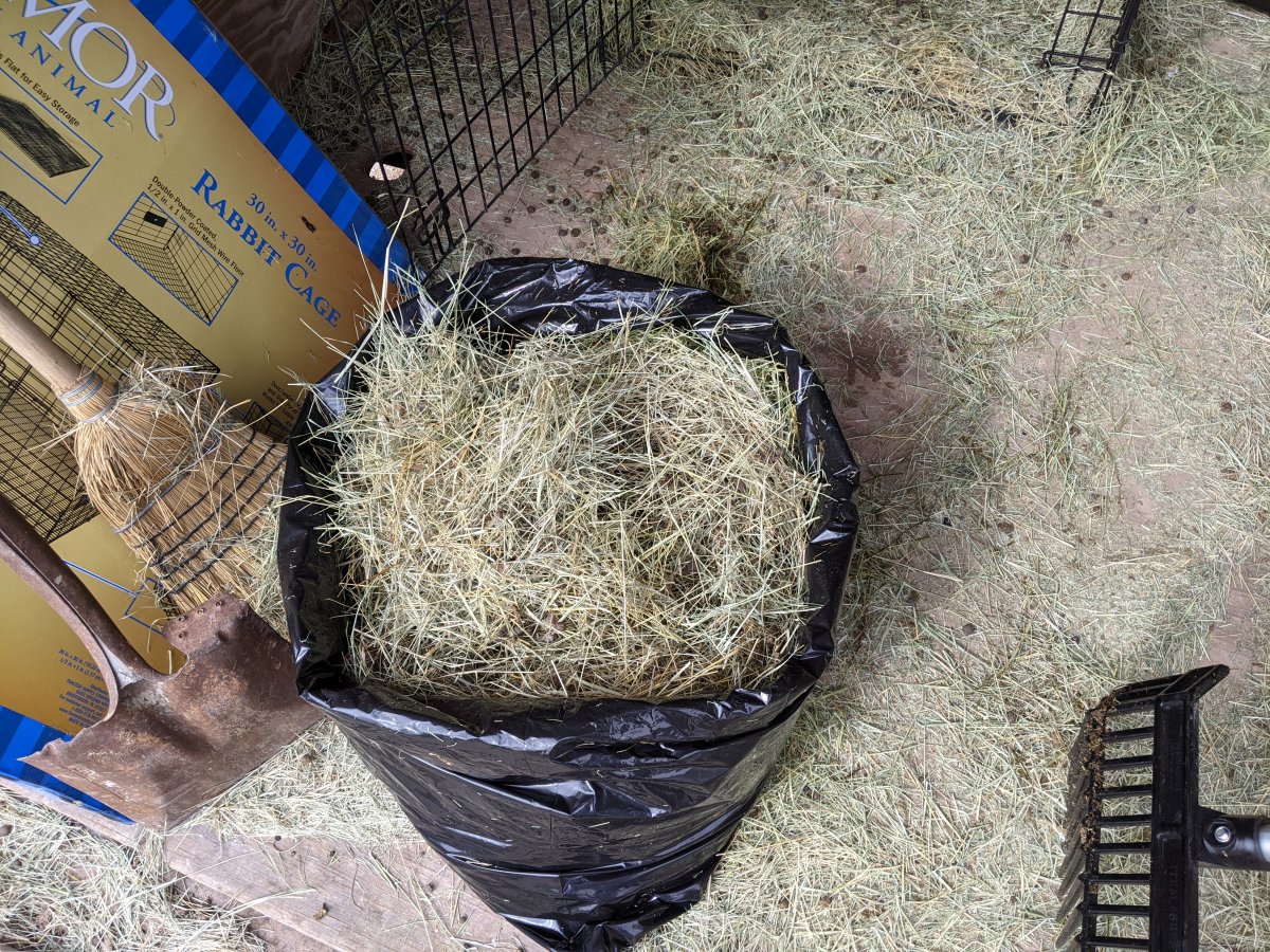

So after watching a bunch of videos, I decided to plant taters in black garbage bags utilizing "bunny hay" (the coastal hay I give my bunnies after they have played, pooped and peed on it) and our regular soil which is fairly heavy on the clay but fine-textured. And no, I haven't tested it yet - got tests coming because it seems I love to get ahead of myself. After reading this thread, I'm thinking it is going to get too hot here on the bags (high desert west Texas, elevation about 3000 ft zone 7a, 7b or 8a depending on the map you consult). Seed potatoes from TSC, Yukon gold, Russet, Kennebec. My objective is to use our own resources whenever possible. So I am now wondering if I should have hubby dig a trench to put the bags in to keep them cooler. Or I could place them under our house such that they would get afternoon sun. I have only done a bag of each so far so good time to regroup or to try something different with the rest of the seed potatoes if necessary.
I was planning to "hill" them with more bunny hay, maybe a little soil as well. I put more hay on after planting. So it was about 5-6 inches of bunny hay, 3-4 inches of dirt then another 5-6 of hay to start. I have tiny slits cut in the bottom of the bags and was watering thoroughly once daily.

I strongly suggest that you abandon the trash bags. Taters like cool soil. Dig a trench, bury your seed pieces, then use your bunny hay to deeply mulch them. Potatoes are heavy feeders, so... if you don't have enough natural fertilizer, I suggest that you use a granular or liquid fertilizer of your choice. Keep the soil moist. Taters don't like it very dry.

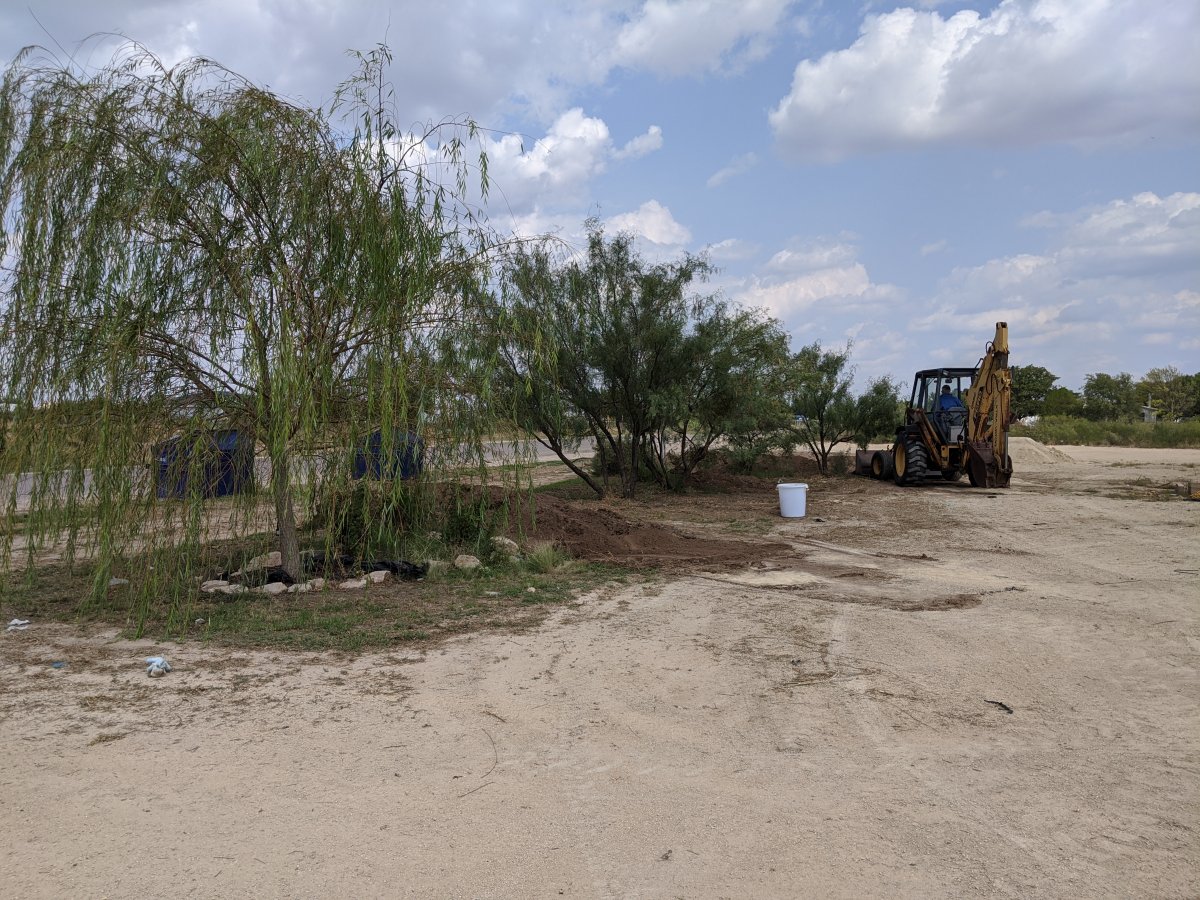

So hubby wants to experiment. So going to leave those three bags and see if his thoughts on evaporative cooling work. He also agreed to dig me a trench to plant the rest of the seed potatoes. Trench digging requires our backhoe (old one he fixed up worth its weight in gold) because a 12 layer of limerock (called caliche here) is at various depths nearly all over our 2 acres. He also is always willing to rig me out with micro-irrigation. It is so dry here. We have had to do a lot of experimentation.
This photo is from the fall where we were working on the front of the property. That willow tree is one of my pride and joys as I planted it. The other trees you can see are large mesquite bushes we trimmed up. I planted two more willow trees and hopefully will have the same success. The backhoe is in the photo. Most of our property is covered in crushed caliche called chipbase to keep the mesquite at bay. It's a constant battle though as they are perfectly capable of sprouting on top of the chipbase, thank you very much. lol

I am really surprised at the weeping willows..... the ones that I am familiar with require alot of moisture.... they mostly grow near wetlands/swampy ground or along the edges of creeks and streams and lakes/pond.

I have to work with my husband's genius. lol. I asked about making some temporary raised beds out of hardware cloth. I was going to layer the bunny hay and dirt. He gets to thinking and the next thing I know he is talking about something that is off the ground and has a mini greenhouse on top. It's worth it because often his ideas turn out GREAT. But sometimes they keep things from actually happening. I don't know if you know anyone like that. Anyway, there were other weeping willows in the area - I think they put down really long roots or something. But ours is from a nearly continual micro-irrigation drip. That first one went like gangbusters. The second one I planted, my drip kept getting turned off when a renter in our little RV spot would use the hose or outlet and not turn it back to how it was. So last fall he plumbed all that underground for me so it is solid. So my poor little second willow and the third we planted should really go this spring. I can't WAIT. The other thing that grows very well here with micro is roses. No disease or aphids to speak off so with water and some fertilizer they take off.
