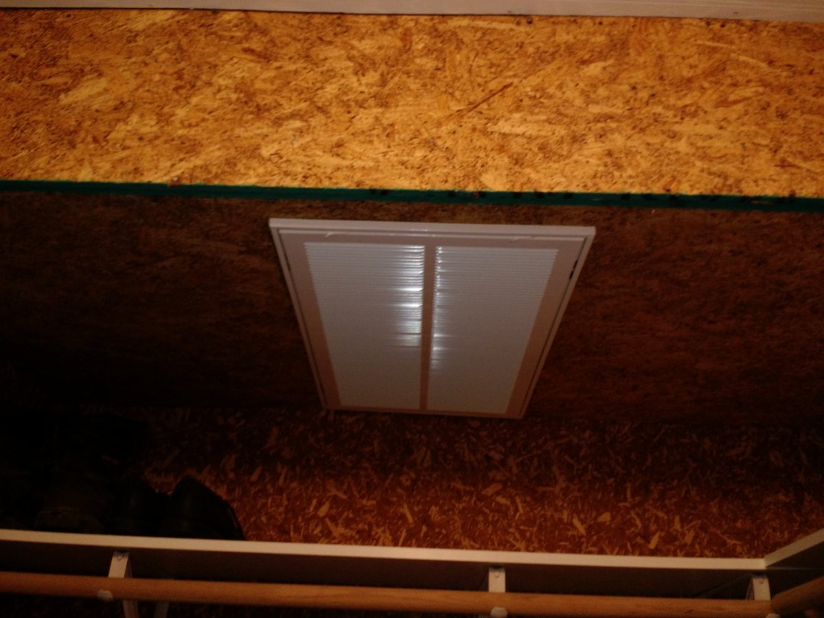

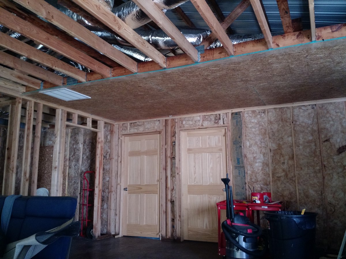

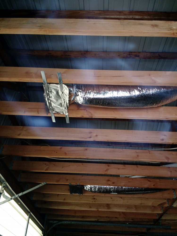

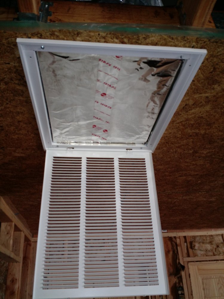

My wife and I I got up at the crack of dawn Sunday morning, so she could baby-sit me while I was up in the attic. Over the 3rd of the man cave that's insulated. Even then the attic was still hot. I was up there about an hour and came down soaking wet head to toe. But my plan worked :). I added the fabricated box two 14" start rings and a length of 14" insulated flex pipe, cold air return grate and filter. I blocked off the other cold air return with some wide foil tape covering it's filter and also the same for all the registers in the un-insulated. I also moved the thermostat into the insulated 1/3. My plan worked, maybe a little to well... Good Lord this carrier unit blows so cold, it makes my nipples hard.
New cold air return
Here's a pic of the cold air return in the un-completed section, that was installed by the heat and air company. I sacrificed one filter by covering it with foil tape. I still have 11 more new filters in the box.
And the wide foil tape covering the registers.
