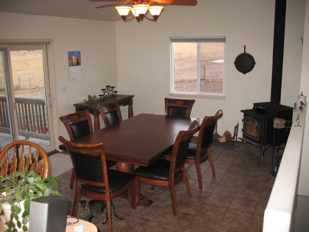

We heated mostly with wood for 7 years in Wyoming. The house we bought had a woodstove already installed and we added a second one. The first one was installed in the corner of the dining room, not the best location but it was there so we made do. We had to use a fan to get the heat to other areas of the upstairs, like into the bedroom, but we loved the warmth. The house had a propane forced-air furnace, that we used as a back-up. after adding the second woodstove in the basement, we burned about 8 cord of wood a winter and kept the house toasty warm.
IMG_3430.JPG this is the dining room stove. The same model of stove was installed in the basement.

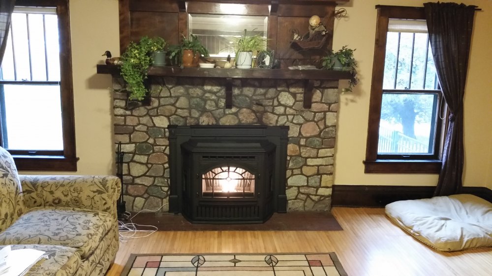

We purchased an old farmstead when we moved to Wisconsin. It is farmland, so no real supply of firewood. This house had a big old fireplace in the livingroom so we installed a pellet insert with a thermostat.
It is helping to cut our heating bill and does a great job of heating the main living area. however, the design of the house does not really allow for transfer of radient heat to the kitchen, bathroom and mudroom areas so we moved the thermostat for the furnace to the hallway by the bathroom and shut the furnace vents to the main areas where the pellet stove will heat.
We have to buy pellets, but we don't have to buy firewood. Our intention is to grow old here and we feel that our age will soon limit our ability to cut firewood so we opted for the ease of pellets.
