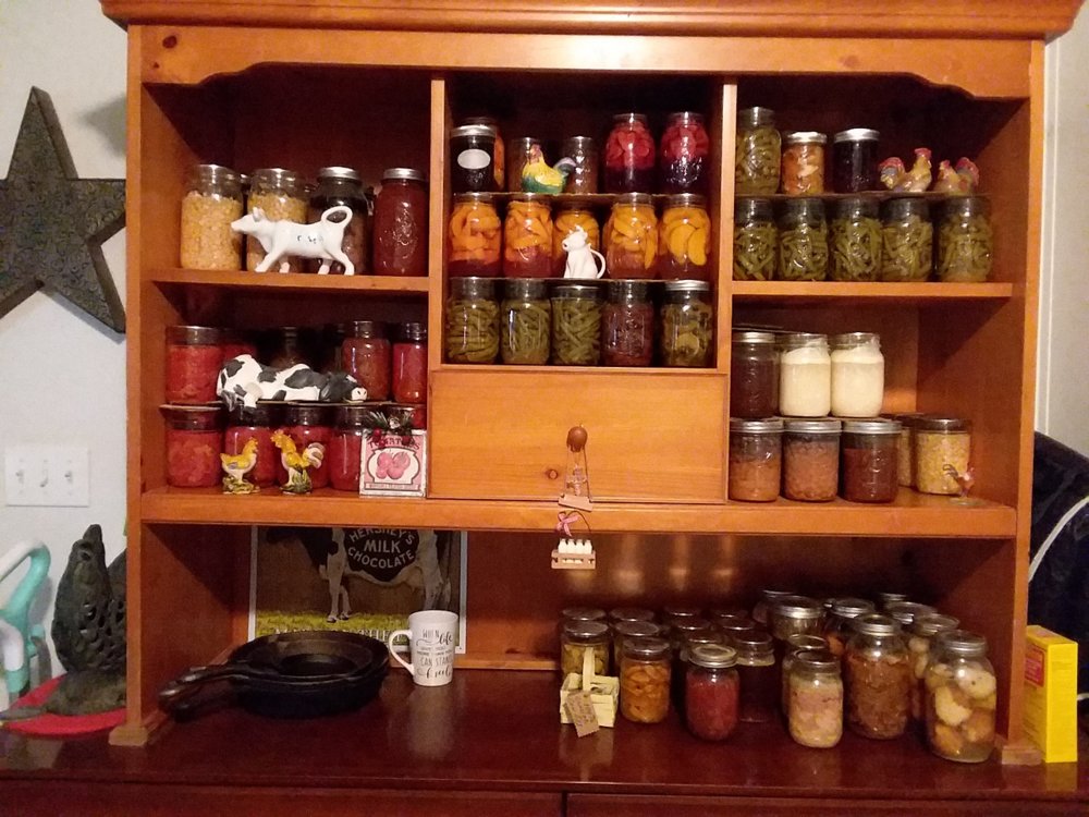

What's the general opinion about stacking filled jars with cardboard between layers?
I've heard that it's perfectly fine - others say it's a death sentence.

That sure is pretty, Cane! I wouldn't do it with qt. jars but have done so temporarily with pts. I've heard down through the years of folks who had jar seals fail from stacking jars one on another, even with a layer of cardboard. Those jars are mighty heavy.

Nice work there. I would add a ledge in case the Earth decides to shake a little and also more shelves. Wife about had a cow when I stacked full jars on top of each other. Said you can't do that! I was living in NC when that last earth quake hit somewhere in northern VA man the telephone poles we're swaying.

The problem with stacking the filled jars is that if a jar loses its seal for some reason, the jar on top keeps the lid in contact with the jar. If it later seals again (which can happen with fluctuating temps) you will not know that the seal was breached for a time... could be dangerous.
