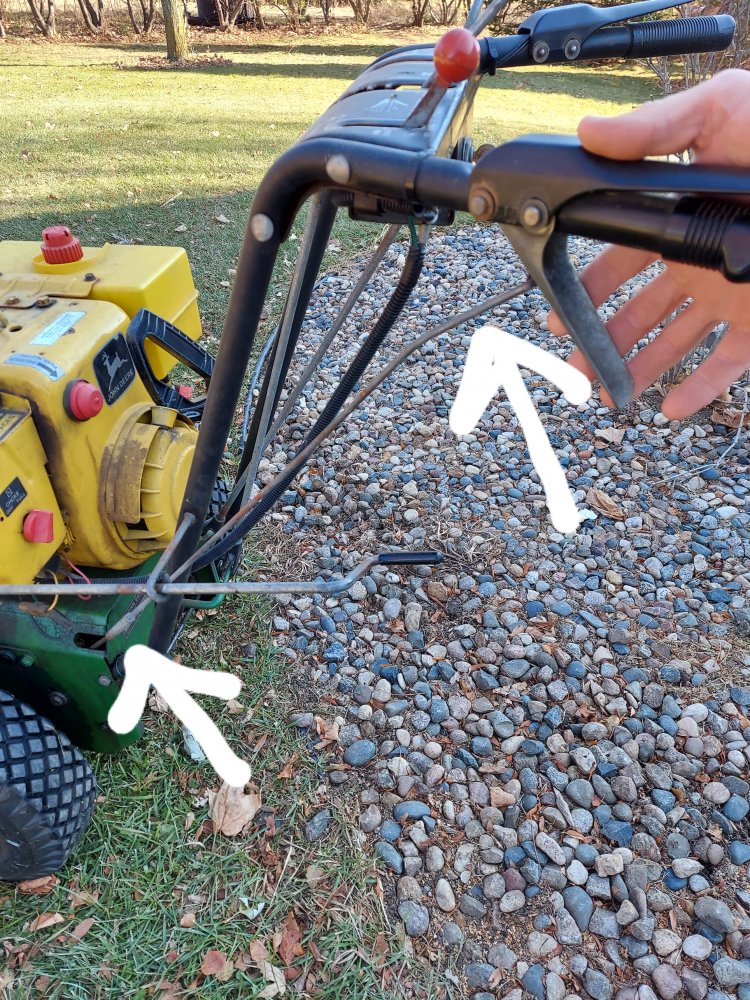

What do you call this rod with the spinning barrel connector in the middle? It engages the friction disc.
Problem is I need to tighten that connector because the disc is in constant contact, so right on start up the blower wants to GO. However, that barrel connector is completely seized up. I tried heating it up and getting some lubricant in there, but it won't budge. Trying to find out what it's even called so I can see about just ordering a new one.
