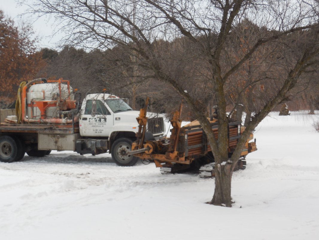

They are here!
Here's the horizontal drilling machine next to my crabapple tree.

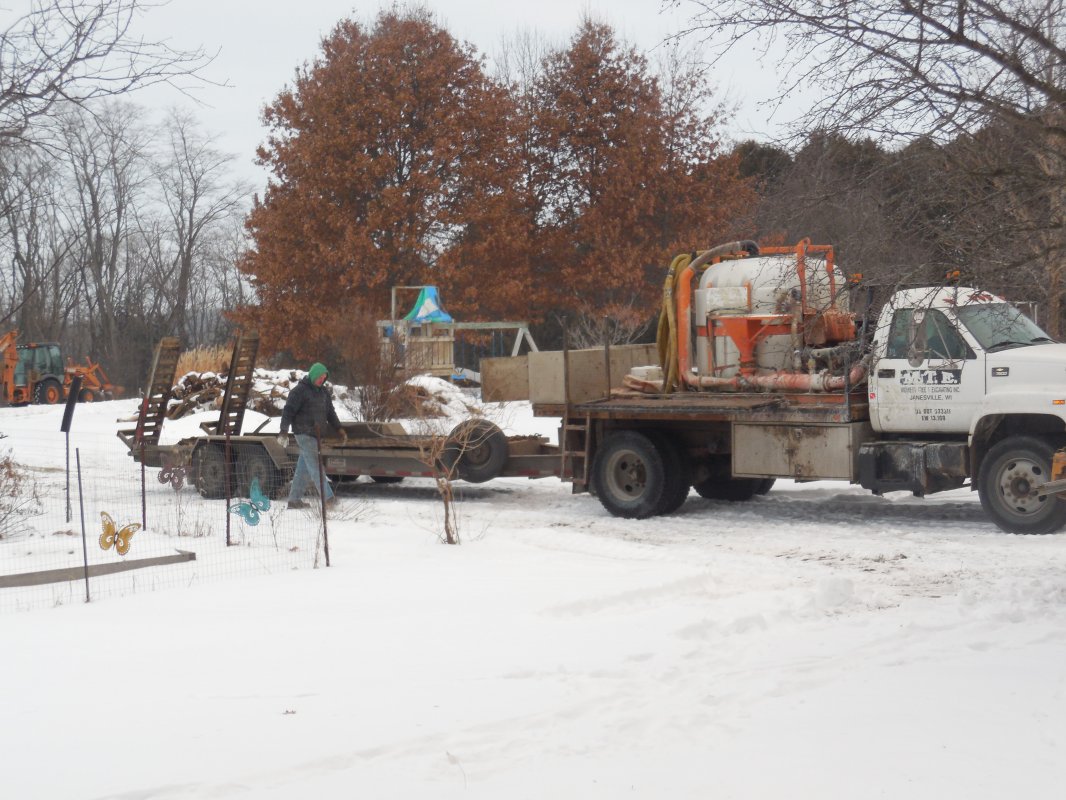

Here is the water source for drilling, and way out in the field is the back hoe.

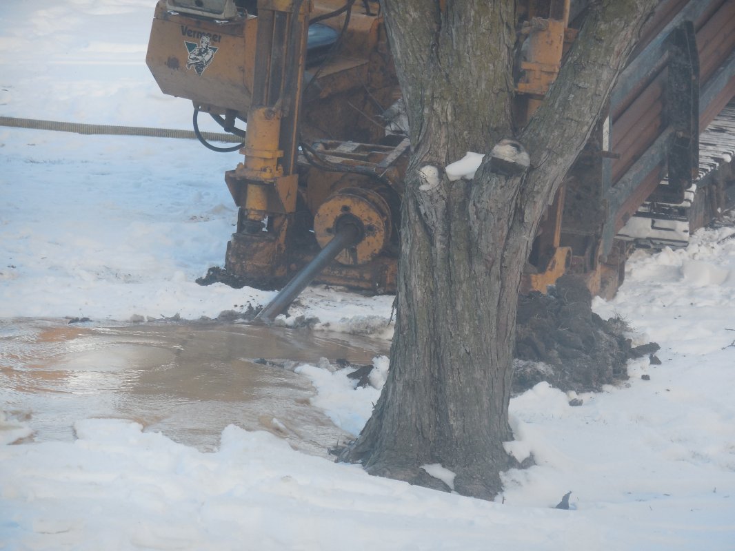

Behold! The horizontal digger at work.

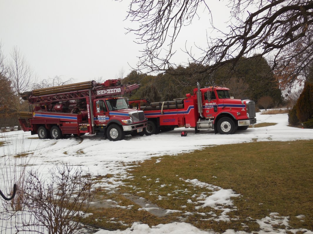

Today, Saturday we sat down to a lunch of homemade corn chowder. When we finished eating, DH looked out the window to see a large flatbed trailer and some new machines. Supposedly, we are going to get a vertical bore system now instead of the horizontal system. This means the contractor will be digging five vertical 'wells' or bore holes down into the water table. This 54 degree water temperature will be used to heat the fluid in our piping, pumped into our heating unit inside, and heat the house. There will be no contact between our system and the water beneath us so there is no danger to the water table.
The bed and Cat are here, but we see no sign of people and no truck used to bring the flatbed. We were told "maybe" the newest addition to our project would start on Tuesday. Perhaps the workers are eager enough to start sooner.

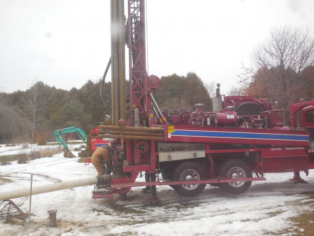

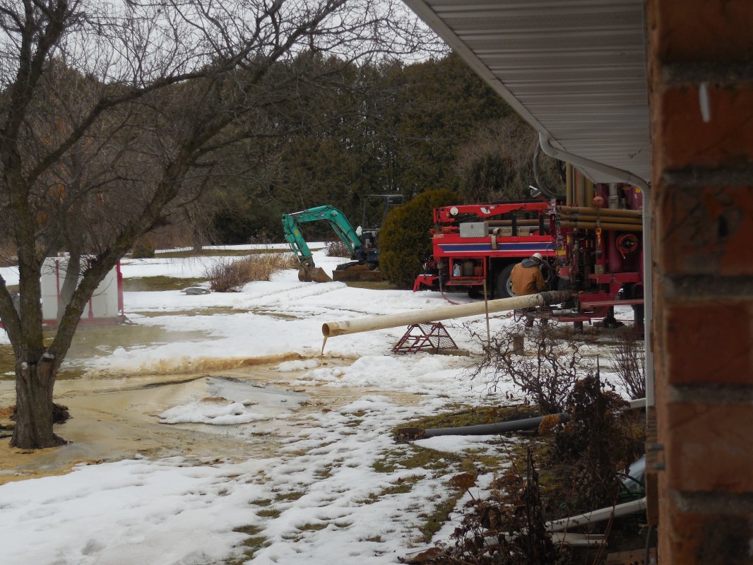

Today is Tuesday, January 20th and the drilling crew arrived about 10:30. I wish I could share the sounds and vibrations of the machine drilling beside the house. Such music to my ear after waiting for so long.
Smart Red
Jan 10, 2012
329
47
93
Wisconsin

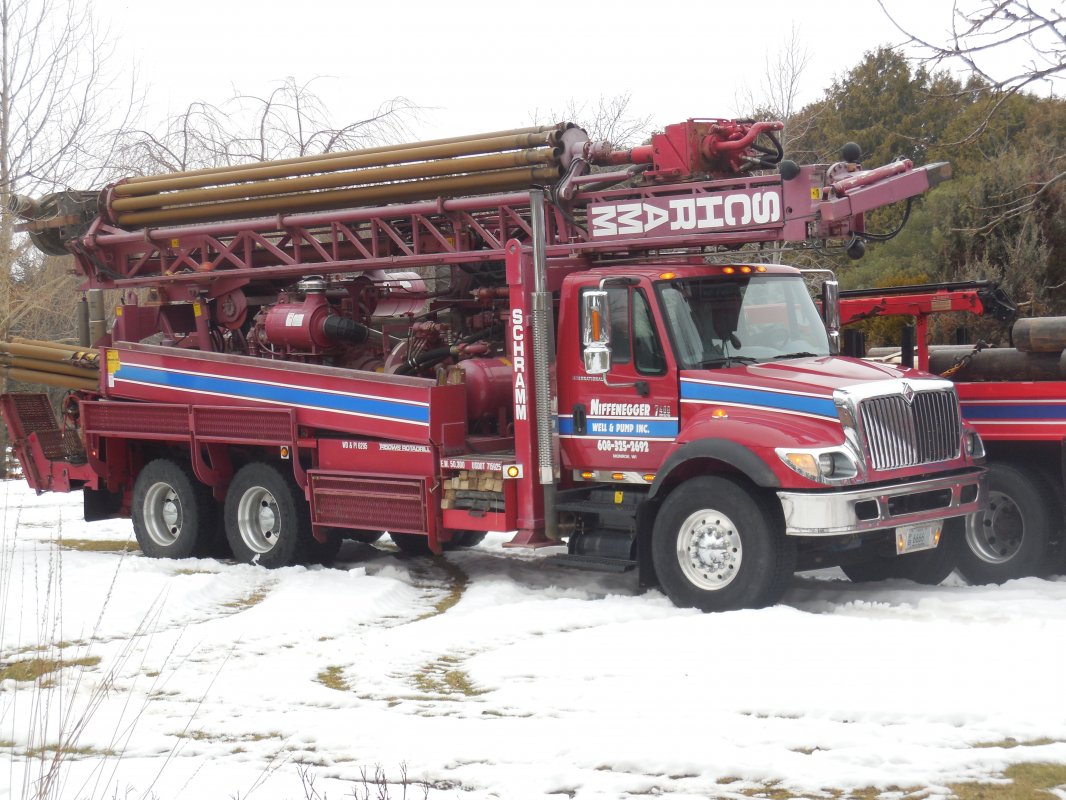

Here they are at work. They didn't get started until after noon today.
Here is a peek at the mess their drilling leaves. I'm not sure what this mess will do to my dahlia bed, but I'm not complaining. I just want them done.
I think they have completed the first bore hole and have been working on a second. At two hours per hole, they may well be finished tomorrow and we will be ready for the inside work.
:thumbsup Color me happy!
