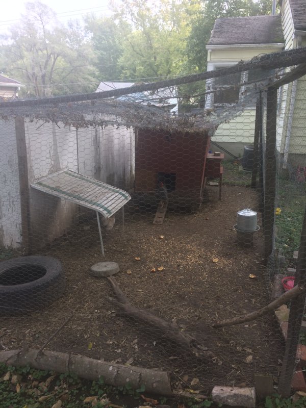

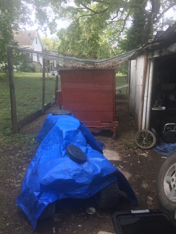

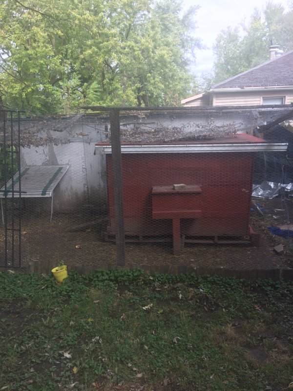

Here is the exsisting monster. Without a fork lift we wouldn’t be able to budge it. The bottom is two shipping pallets connected together and planked for the floor. The fence is also caving in thanks to a huge silver maple coming down on it and the shed this spring. Also the jery-rigged frame for the fence didn’t help one bit.

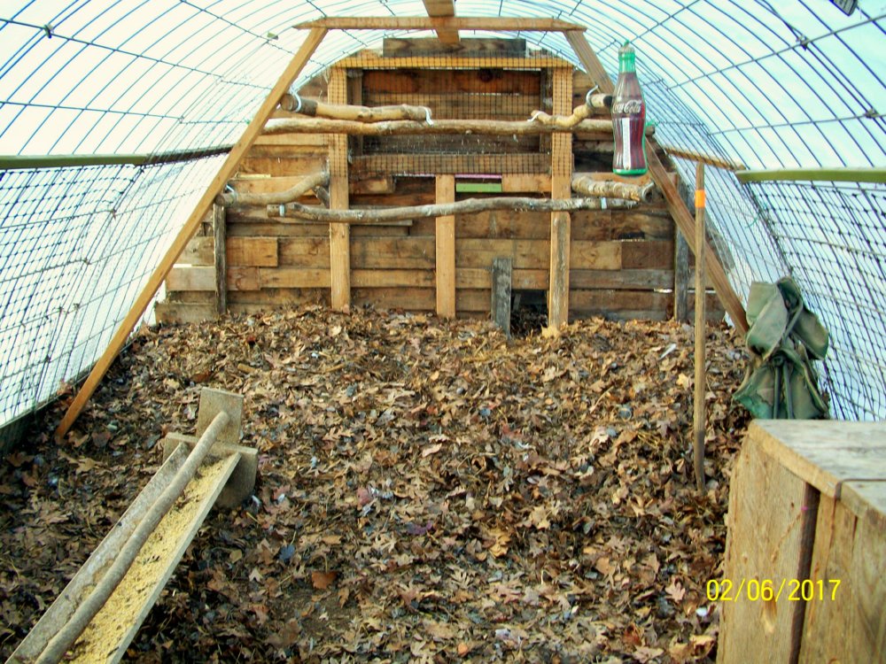

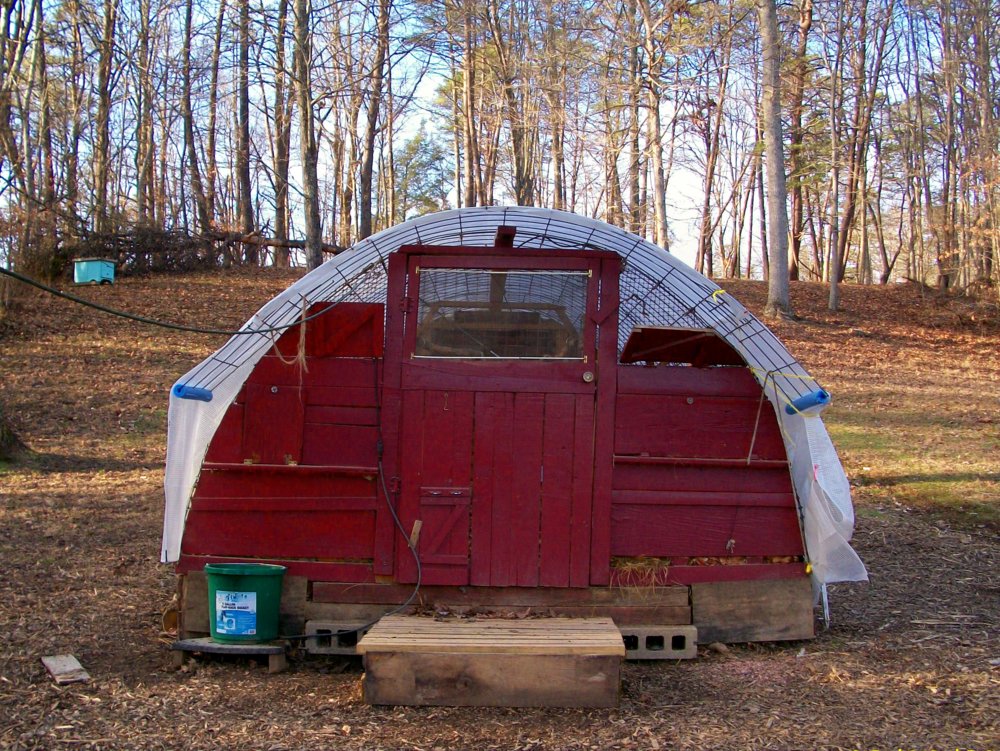

I have a hoop coop that measures 10x12 and it cost me around $300 total to build, that's including tarps and hardware. I was able then to build in the ends and even attach a dog house with lumber scraps obtained for free. Mine doesn't include a run, though, as I free range all the time, but it could very well have a large run attached for minimal expense.
Those grow frames are cool, I like that. I have 2 hoop coops, they're great in the warm months but haven't figured out how to make them warm enough in winter.

I think I have it figured! I built in my end caps and applied a clear tarp in the winter months, while also cultivating a composting deep litter under the roosts. The addition of the clear tarp was really the clincher....so sunny and warm in there, even when the birds are snowed into the coop.

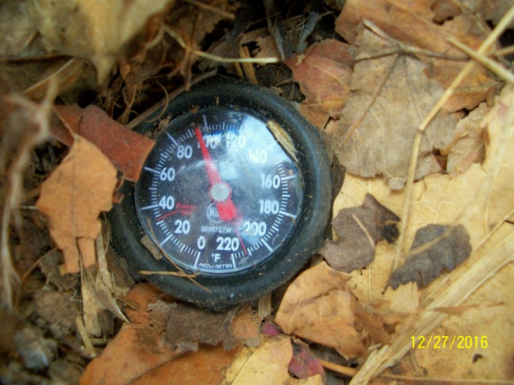

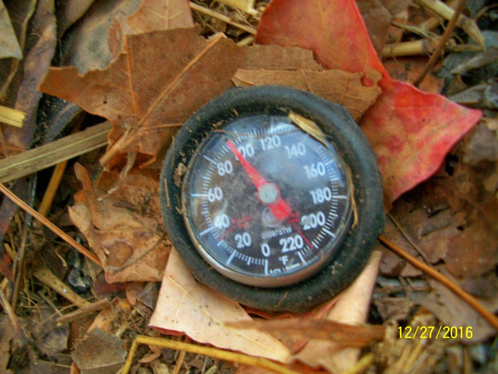

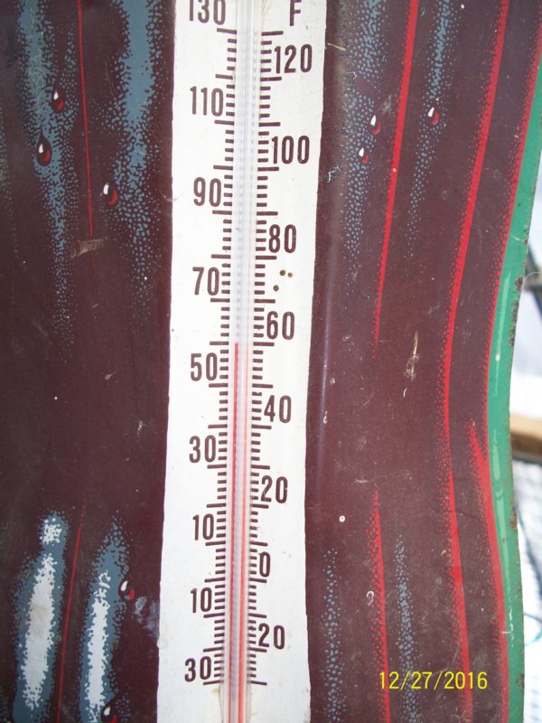

Here's a few temp readings in the DL under the roosts on a typical winter day...the old Coke thermometer is mounted at roost height and often reads 10 degrees warmer at that level than the outside temps due to the warmth of the DL at night, but on this day was reading over 25 degrees warmer than outside temps during the day time . And that's with half the front door remaining open air, huge openings on either side of the door open, a pop door right under the roosts open and open areas right at the heads of the roosting birds, under the roof.
Meat thermometer shoved into the deepest part of the DL under the roosts.
I LOVE the clear tarp in the winter...like sitting in a greenhouse now in there.
The only tweak I need to do this winter is arrange for more water to flow into my DL under the roosts so as to get more composting...the new tarp is so leak proof that I lost valuable moisture I really needed in there this past winter. This winter I'm going to pipe some in with an eave applied to the attached dog house on the back, in hopes of getting more runoff into the litter mass. Yeah...I know...everyone else is trying to keep moisture out and I'm trying to pipe it in, but I don't have to worry about excess moisture with this setup....got the ventilation JUST right.

The run is ventilated...but that coop? Not a bit. We like to call those death boxes.

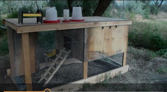

@Beekissed we're looking at adapting this one here that we found on instructables
We'd add a door we can open and close from outside the fence to put the girls up at night and the top of the run most likely wouldn't have a roof. Plus adding a window on the side facing us that would be for ventilation. I'm assuming the nest box is on the other side, if not then we'd put it there across from the window. I have a general idea in my head I just suck at trying to draft things so I'm simply looking for one that matches the one in my head as close as possible and tweaking it here and there.
