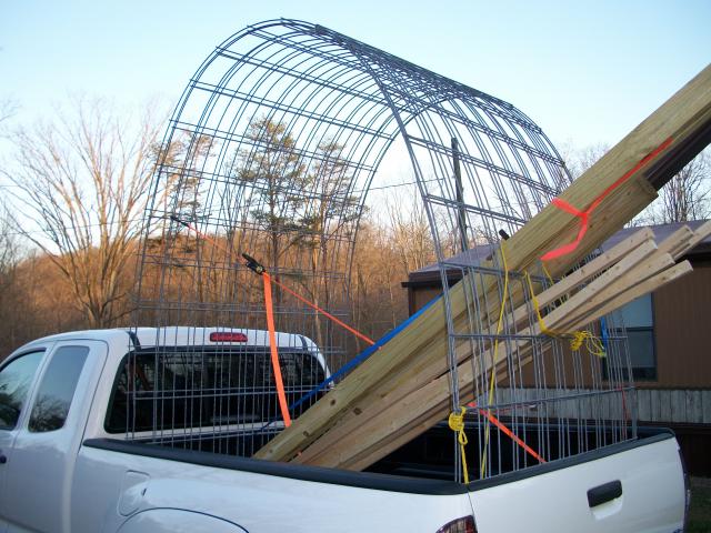

So far, total cost of materials to build one hoop style coop is $160.00. If one wants to predator-proof it, it would take an additional cost of finer gauge wire overlay and for a wired bottom to the whole coop. I don't need this extra precaution due to the dog, so my overlay to keep chickens in the coop will be a very cheap solution of plastic deer netting zip tied to the cattle panels.
Anyway you slice it, $160 for an 8ft. x 10ft. lightweight but durable, portable coop is pretty sweet! :D Not to mention one that can be constructed by a single woman and very little power tools. I'll be using a hammer, and a sawsall for cutting the cattle panels.

I'll be posting pics and plan on taking detailed pics as I go along as this will be added to my webpage and my book. I'll post them as I go along so as to not crowd one post with too many pics. I even took a pic of how the materials fit onto a pickup truck! :p My mother couldn't understand just how to fit 16 ft. panels on an 8ft. bed, so she got a real quick education. :D
Rode like a dream, no shake, no sound....just solid transport.
http://www.sufficientself.com/forum/uploads/5_coop_materials.jpg
Love that pic!! Be careful opening that! Boooiiinng!!! ;) I've heard folks describe loading cattle panels like that, but never seen it! :lol:
