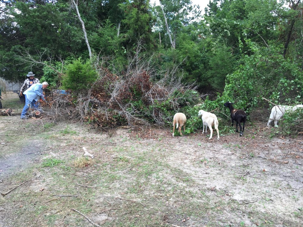

We have Dorper/Katahdin cross sheep with a Dorper ram. We have 5 ewes and are keeping 3 ewe lambs from this year's lambing. We sell lamb for $8 a pound hanging weight and have 3 wethers sold when they get to slaughter size. Our pastures are not good, we are working hard to improve them. We cut green briars out of a one acre "pasture" last summer. The sheep loved them!

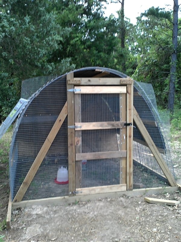

For shelter you could build a hoop shelter from cow panels.

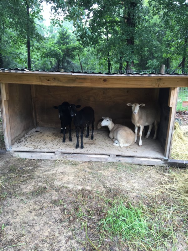

Our lambs like the Hawg Hut I built.
