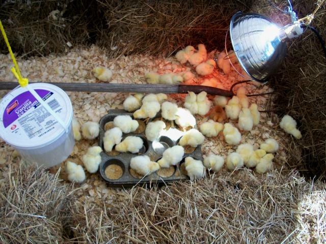

Do you have an outbuilding or garage? If you don't want to build a brooder you could just erect a temp one in these structures. I did mine in one side of my cattle panel coop but just formed walls with hay bales and topped it with plywood when it was really cold. The bottom was heavy cardboard and this kept them dry and warm from the cold ground, plus a layer of good pine shavings and they were set. It was an excellent brooder and I'll form one just like it the next time I need a brooder.
