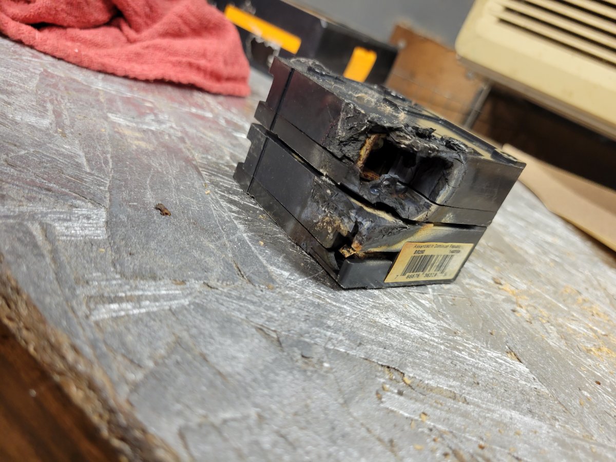

here's the old breaker. I'm gonna say loose connection. seen it before with air-conditioners.
Yep I would agree with you on your assessment. Heavy loaded (high amperage) appliances need a firm, tight connection to the bus bar. A few times I've heard a buzz come from the panel box. Pulled the buzzing breaker, cleaned it's terminals and pinched them tight with needle nose pliers
I would tend to agree with your assessment. Loose or dirty contacts, maybe even not punched down all the way.
