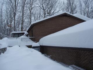

I took this photo this morning while shoveling my way to the heatpump to shovel it out. The house is built into the side of a hill, so this back area is ground level. At the front of the house, it is two stories high. At the far left is the sunroom with the flat roof. In the back, you can see the main house with the snow that fell last night. You see that DH didn't manage to clear along the front edge of the main house. At that point, it is a 2-story drop and it was dark out, so I can't blame him. The portion closest to you is the garage which has the full weight of the snow at this point :( It houses part of DH's prized muscle car/convertible collection.:fl
I have since cleared the snow above the gutters on the garage. I think we'll get another 6" before this is all done for the day.

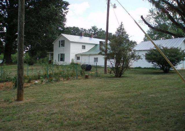

Thanks for the offer, but I'm pretty sure the back part of the house was added on by the 'do-it-yourself-even if-you-have-no-clue' original owner. Certain sections I'm convinced are still standing out of sheer habit. :rolleyes:
You can see what happens here is that it slides down from the upper roof and whumps down on the lower, adding to what's already there. Usually it hits with enough force to propel it off the edge of the lower roof. When it doesn't, it's stick time.

You don't mention your location but your roof looks like a 4/12 gambrel and when trussed right will hold all she can take, can't see much of the garage but looks like a simple 4/12 . Since its easy it doesn't hurt brushing it off though it is probably superfluous (if in the deep north).
It's not a gambrel, just a simple gable. I was guessing it was 3/12, but 4/12 could be right. The house was built to code in 1985. We're just wondering how good code is when you're in the midst of getting more snow in one week than has ever been recorded before. Not to mention we had the roof replaced about 3 years ago and we want to keep it in good shape.

I see that now but the shadows and snow made it look different to me
3/12 is a southern slope - 4/12 would be used to the north without almost no exception unless a handyman built it and that doesn't look obvious in your case.

The existing house looks to be 4/12 and garage 6/12, the stepped addition starts out at about 8/12 but then goes to a shallow slope of 2/12. If you are north of the Mason Dixon and looks as old as it is then somebody has been lucky over all these years.
But as reinbeau suggested re-doing the trusses to make a deeper pitch would be best, since your roof is metal it will be fairly easy to remove, Ask your local lumber store for the truss snow load calculation based on the dimensions of the roof, this is normally a free service, they will tell you what you need - heck you might just skate by with a few dozen 2x12s and some jack posts for a knee wall.
