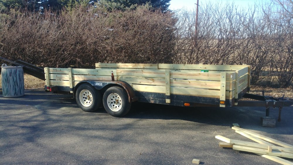

I liked the metal idea but I don't have the time to fiddle with working with metal right now, since it's not in my wheelhouse and I need this in the next week
I got a bunch of lumber and did this today :)
Still need to make a back gate and install some tie down d-rings, etc... But this will get me thru April activities
2,448
Just make sure that you use a scrap of wood screwed to the bottom of the slats under the pockets to keep the walls from popping out when you hit a bump...
