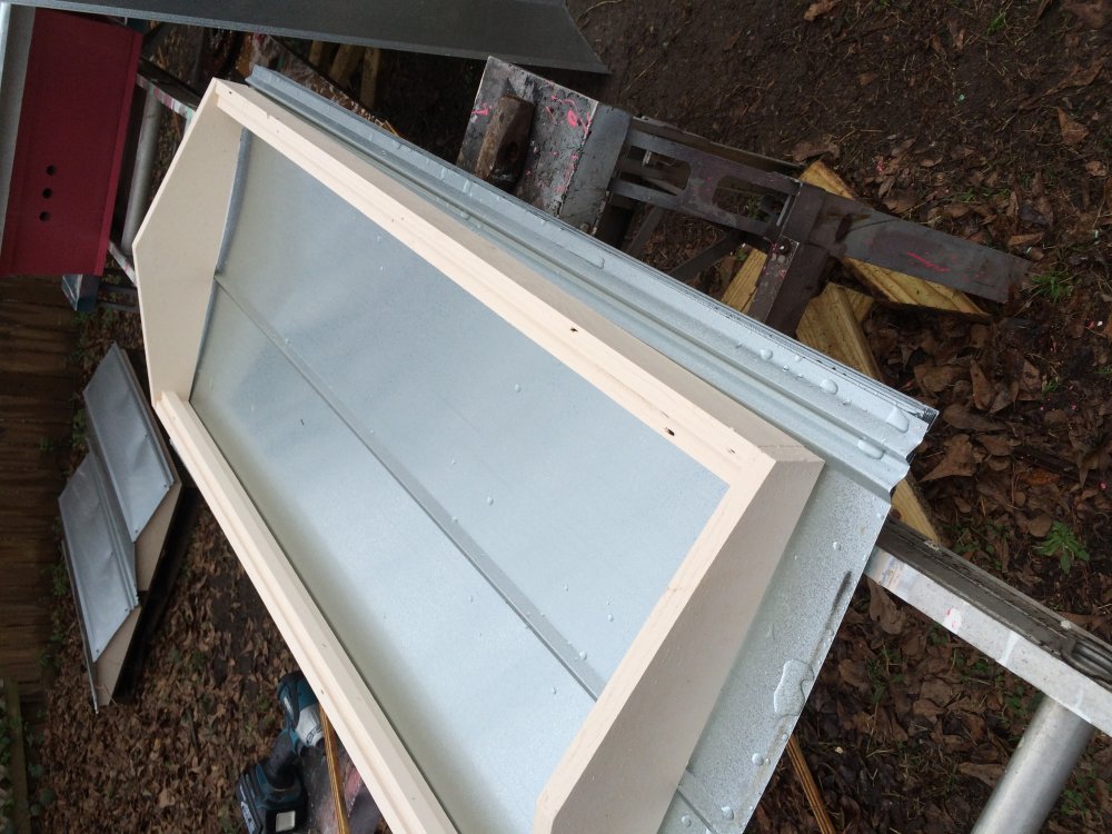

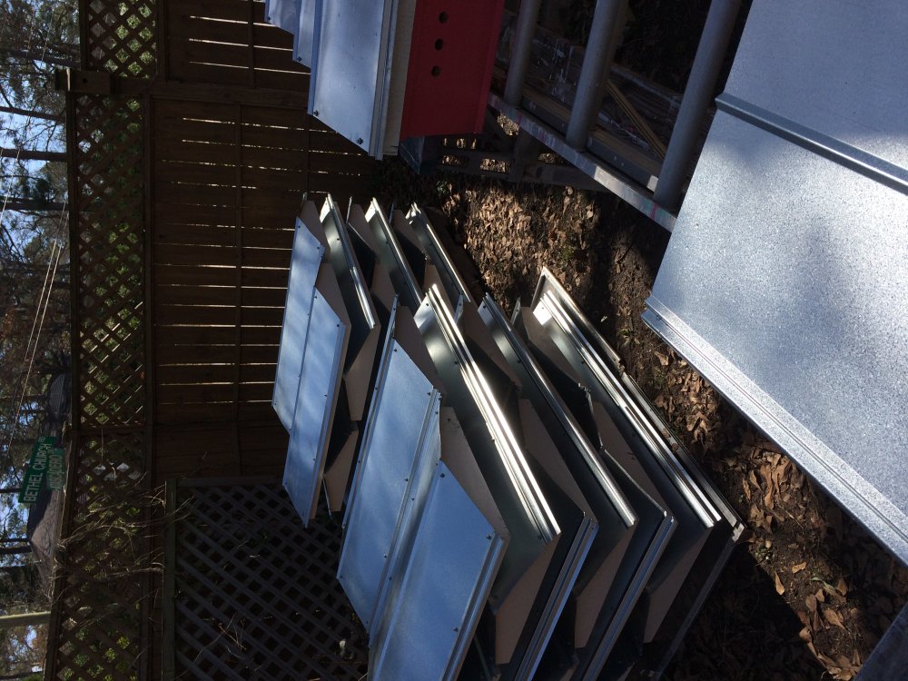

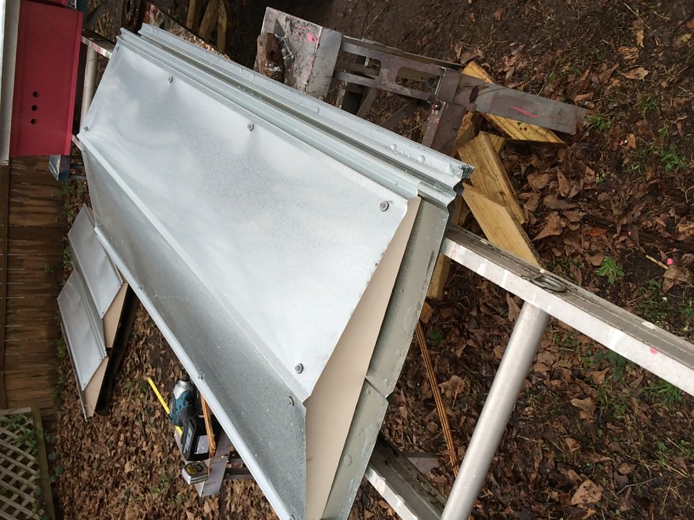

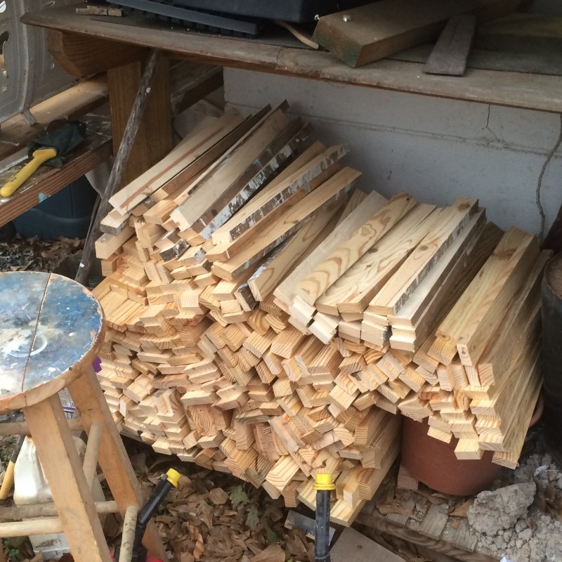

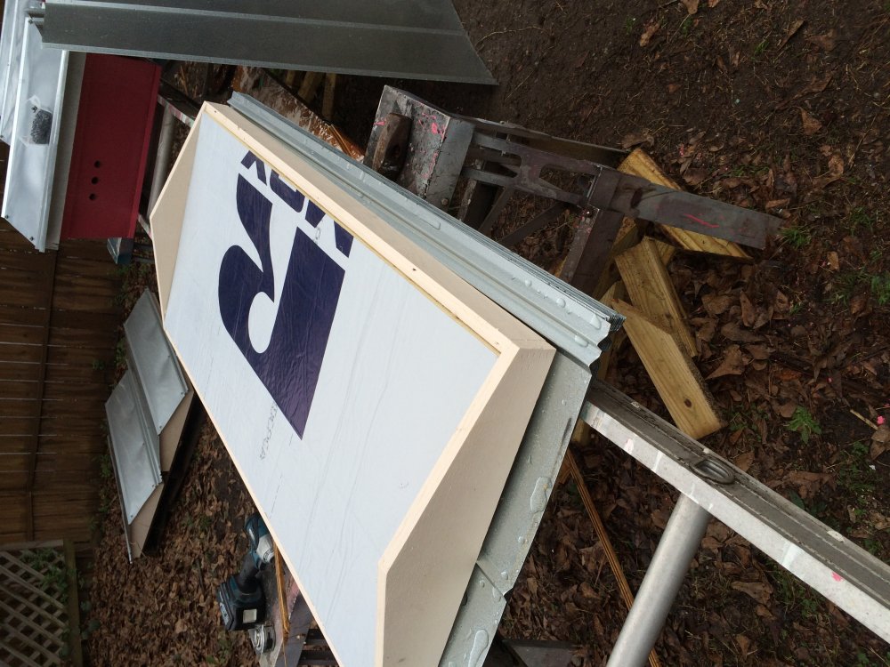

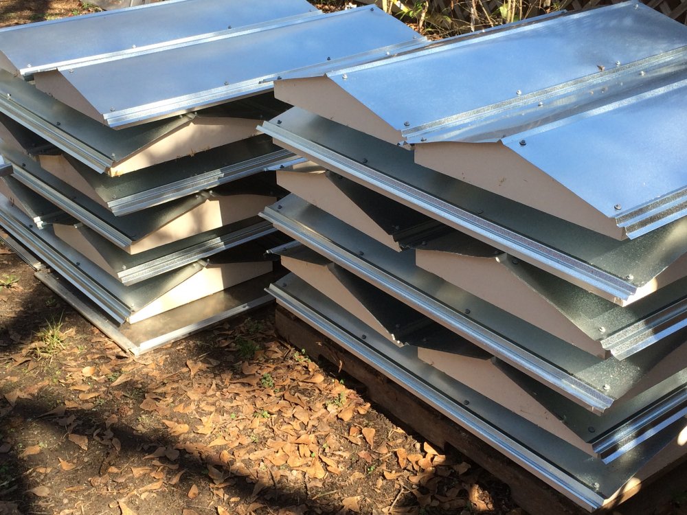

ok, im nearing the end of the build. heres a brief update...... got just shy of 600 top bars milled, but still have to mill and attach the guides. picked up the roof metal for this build and another 24 hives from a metal roofing manufacturer. got all 24 roofs built. all the legs are machined, and awaiting transport to the apiary before attaching them. wont be long and ill have my makeshift shop cleared out enough to move on to the next project!
above is the painted roof frame....
roof frame with insulation installed......
completed roof!
24 painted and completely assembled roofs

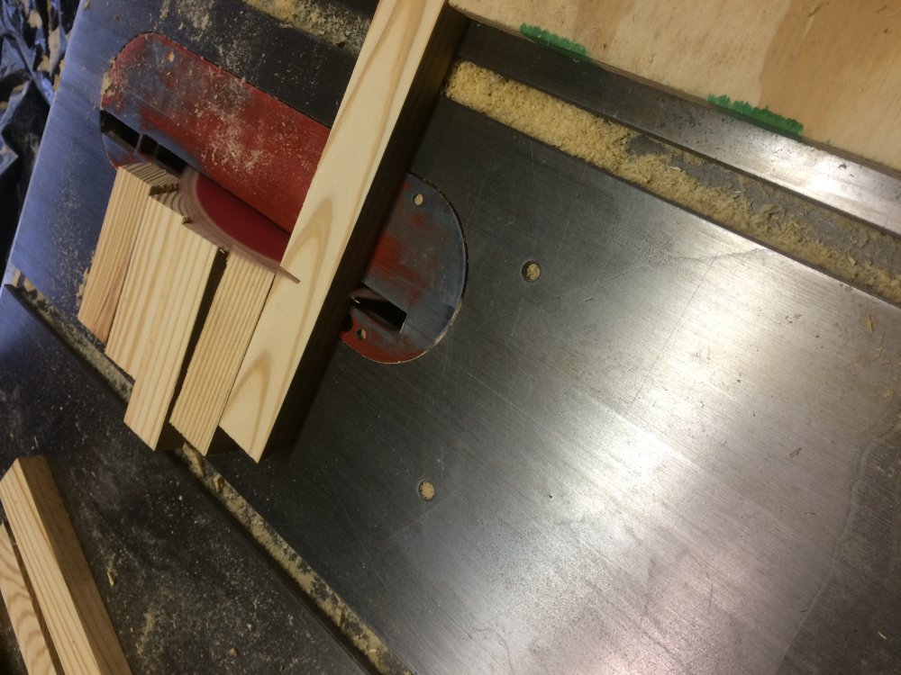

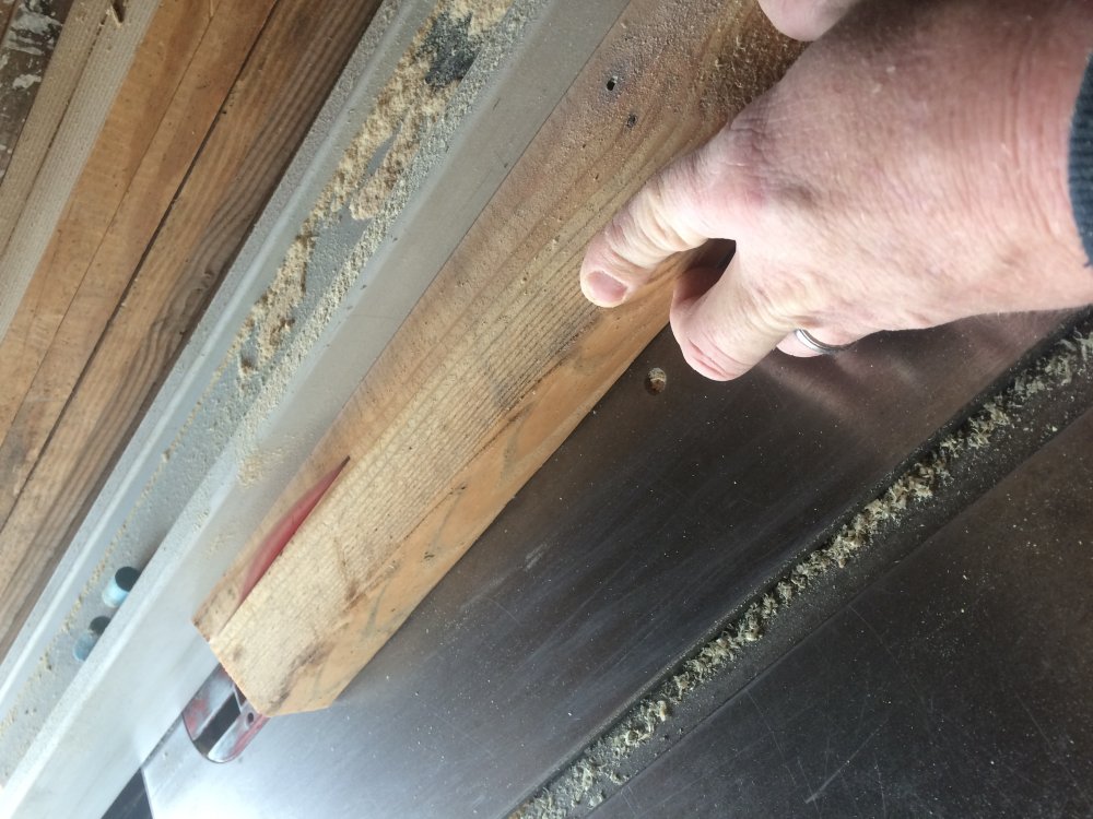

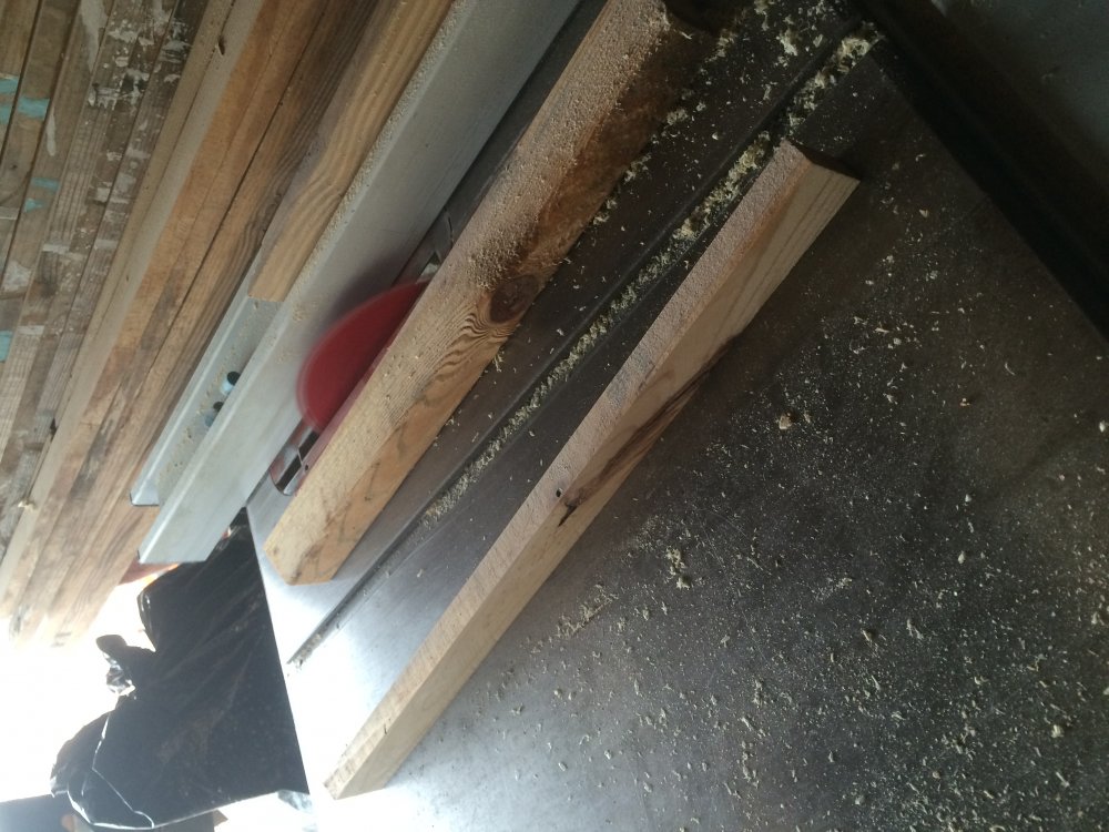

some topbar machining pics.....
cutting up some scrap into topbar blanks....
more sawing....
machining angles on ends and cutting to length.....
bunches of bars awaiting machining to correct width

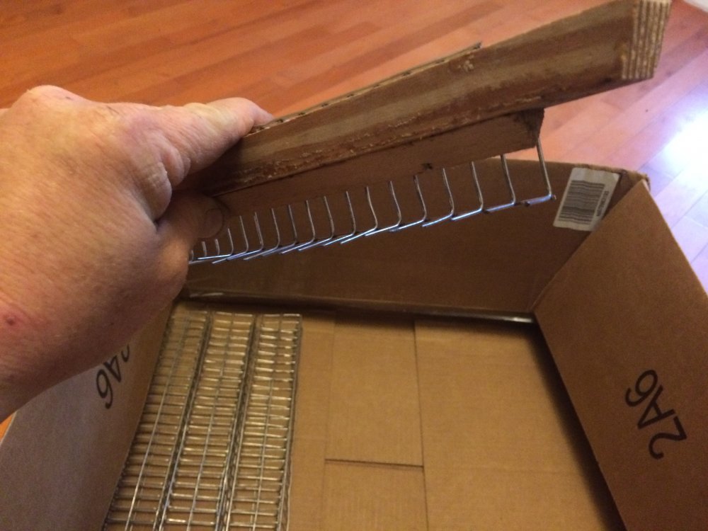

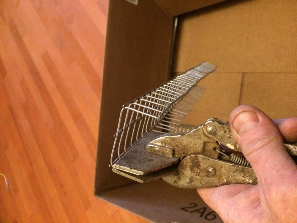

also made up some 50-ish comb hangers from rabbit wire.....
made these up at the request of my friend that does bee removal services. im bartering 2 of my completed hives for 6 colonies installed in my nucleus hives. he will be using these comb hangers to save the existing combs that he pulls out of the hives he removes. once the colonies have stabilized in the nucs, ill transport them out to the farm and transfer them into full size hives. we're also baiting up all our unused equipment to try and catch some swarms. ill get up some more pics showing the completion of the hives later this week if all goes well!
