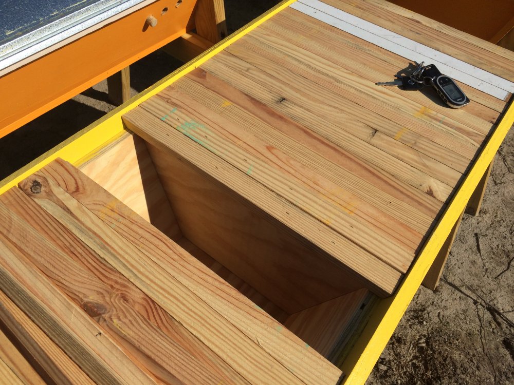

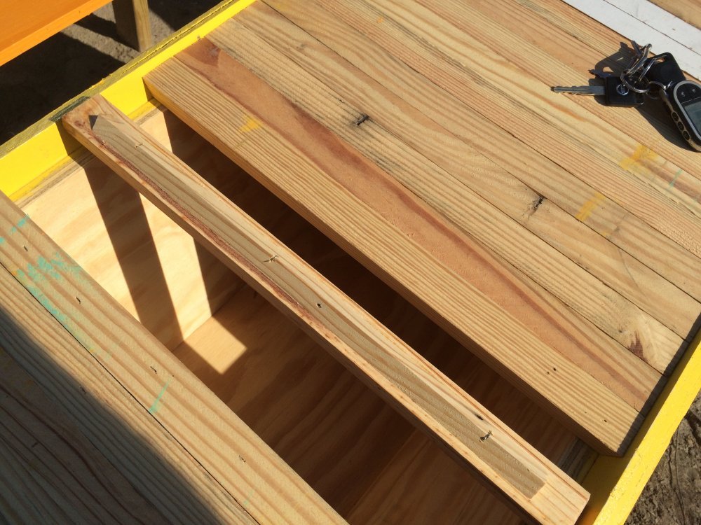

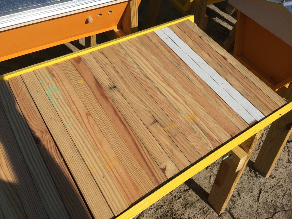

heres how i work one......
when you remove the metal roof, youre looking at the tops of all the top bars. at this point, only the bees going in and out of the entrance are flying around.....
then i find the follower (its the only bar with staples or screws in it. this represents the back of the hive. i remove a few bars from behind it and slide it back leaving a gap between the follower and the active hive bars.....
at this point, i can remove the bars one at a time with all the bees on it, and none of the other combs full of bees respond to me pulling a comb out. the bees on one side of the last comb i inspected, the bees on one side of the next comb to be inspected, and the comb im inspecting are the only ones exposed at any given time. this is FAR less intrusive than cracking lang boxes apart and staring at 9-10 full frames of bees at once.
