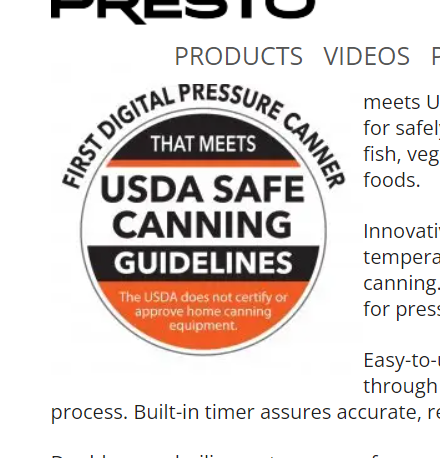

So I found this today, if you watch the first 2 min and 40 sec seems like the electric canner is recommended but not approved by the USDA. So then I went back to the website to order it and yep, sure enough it just meets the requirements but it isn't approved or certified so says the 'stamp of approval'
So then what does that mean exactly? Anyone? If the USDA won't approve it then is it still as safe as a stove top pressure canner?
