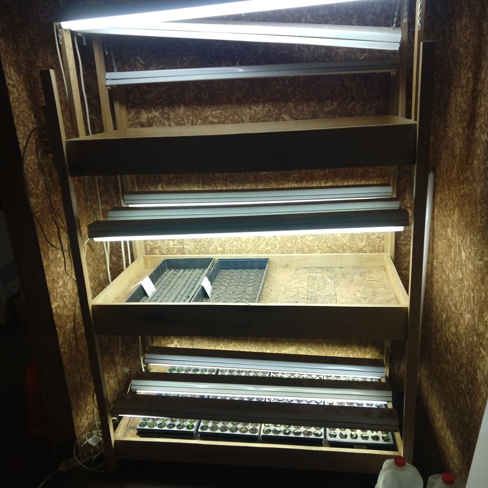

There are three 4' long 2 bulb florescent fixtures on each shelf. Each fixture has one 8000k and the other is 5500K florescent bulb. These are good for growth but not good for flowering. which is what I'm after, because the seedlings will be transplanted into the garden. I'll get a picture of the seed table for you
Each shelf will hold 4 72 cell flats. It's coolest on the bottom shelf so that's where i have the onions and cabbages.

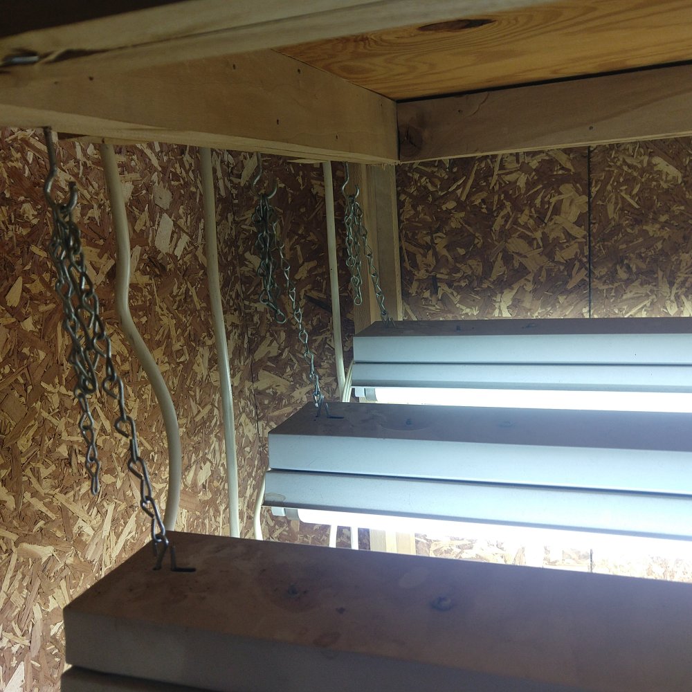

Light fixture height is simple hook and chain adjustment.
This seed table is one of the more practical things I've built. Just make sure the shelves are level because you have to water the seedlings and if not level then water is not equally distributed in the trays.
Edit... Sorry my memory is not as good as it used to be. The bulbs are 6500K and 8000K I saved the packages incase I have to replace bulbs.
