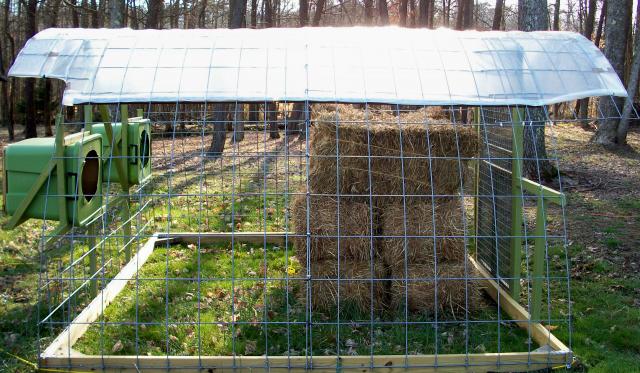

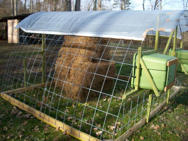

A few more pics of the coop progress. To be honest, this coop has become a monster! If I had known then what I know now, I just would have built a stationary coop and saved myself loads of trouble and a lot of money. I could have put up one of those in a day with half the materials I've bought and used for this portable coop(which is now too heavy to move by one person..or even two!) If I had to do it all over again, I'd just have made the coop and forgot moving the darn thing around anywhere. :p
Here's a pic of the plastic cap that will be under my tarp. I've stapled it to the firring strips I added awhile ago and also zip tied it to the awnings I've since added to shelter the entrance and the nest boxes.
And with the front door added. I just cut down a 36 in. screen door and tried to make it fit but found it had some sag after the cut down, so added a turn buckle to bring it back in line. Works fine now. I repeat...please do not laugh at all my mis-cuts and mistakes, folks! :D I know they are there and I'm okay with it...long as it works and does what it's intended for, I'm fine with that.

Bee- do you worry about strong winds flipping or moving this coop? We have had some windy storms already this year.
We had been thinking of something along this line but using pvc pipe instead of cattle pannels. But we worry about it being too light and blowing away.
3,946
With PVC pipe, I'd worry...but not with this coop. This coop has become so heavy that I can't move it, the lawnmower can't move it....we had to pull it with the truck. I'm adding some wheels to see if it will become less cumbersome but it would have to be tornado-force winds to move it and even a wooden coop can go in one of those.
I've read about these coops in areas where the winds are a real problem and folks report no flipping but you can always anchor it down if you are worried. Tied to a tree or concrete blocks. This coop? It ain't goin' nowhere.... :p
I'm really hoping the wheels can help me move this thing because, if they cannot, I would have been better off to just design and construct it as a stationary coop and could have gotten by on WAY less materials, time and effort. I wouldn't have used the wooden framing at the bottom,would have bought an extra cattle panel and would have gotten done with the whole darn thing in one day.
Hindsight is crystal clear.... :/
