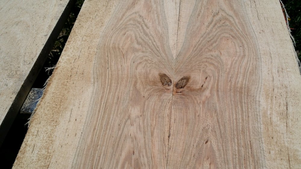

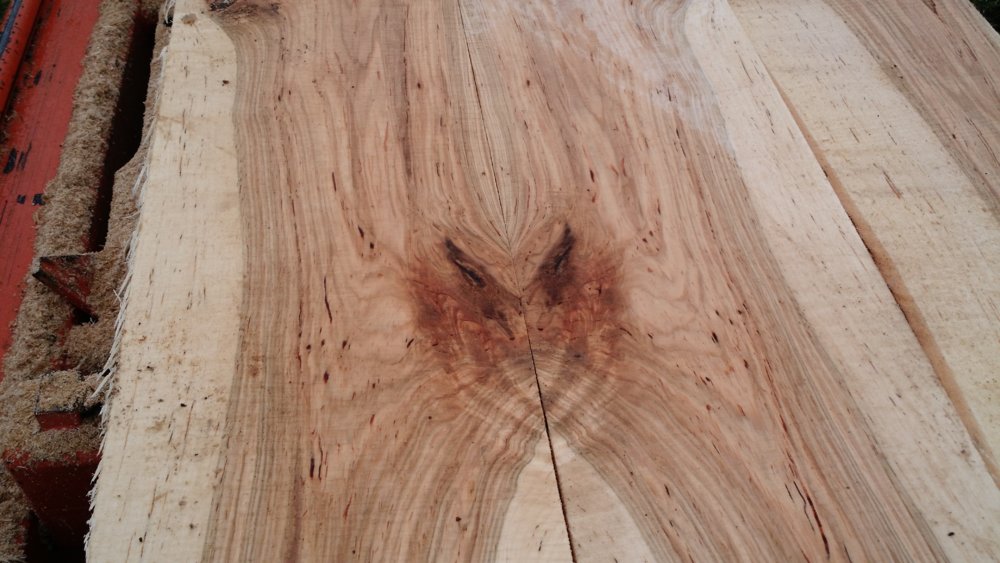

Having fun book matching some red maple on the sawmill. 12" wide boards this might make a cool door panel one of these days. Kind of looks like a evil horny toad maybe? IDK...

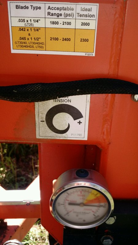

@CrealCritter - Your mill is on a trailer, correct? We have a portable, but it is set up on ground and not a trailer. We have leveled that son of a gun over and over and still have been having slight dips right at the beginning of our cuts when the blade enters the log (we cut our logs at least a foot over what we need for this purpose). Any tips on how to get this dipping to correct, or things to check? We have changed blades, adjusted tension, and made sure the blade guide was close to keep it even. But as I said, right after it goes into the log it makes a small dip! Not a problem for us personally, but if we were ever to mill someone else's log this would be a waste!

Blade dip can be caused by a few things, like entering the log too fast, your blade guides might not be square or your B57 belts might be worn. But I found it's mainly the blade tesion is too loose. Mine has a hydraulic blade tensioner with a guage colored with yellow & red marking on the guage. I run my blades in the red all the time and my blade dip problems went away. I never once broke a blade because I had it over tensioned... When I break a blade it's usually due to trash in a log. Glass, metal, coke bottles, etc...

I ignore the "ideal Tension" and I run .041 x 1 1/4" x 13' 1" Munkforssage blades (German made and sharp as razors). They are getting harder to find but Try http://www.menomineesaw.com
