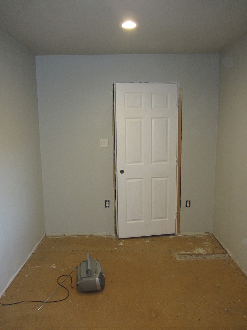

Things are progressing nicely.
  • Canned lights installed,
  • switch installed
  • carpet removed,
  • carpet tack board, pad, pad staples (what a pain those were) also removed.
  • door painted (that always takes longer than I expect it to
Todo:
  • fill in 1/4 floorboard missing pieces (where walls used to be)
  • Lay laminate flooring from Costco
  • Trim around door
  • Install door hardware
  • Run LAN cable
  • Furniture
Here it is (before carpet pad staples removed):
5,340

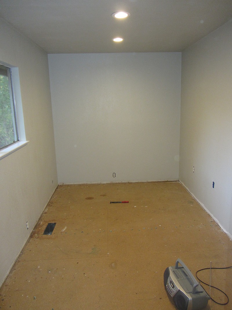

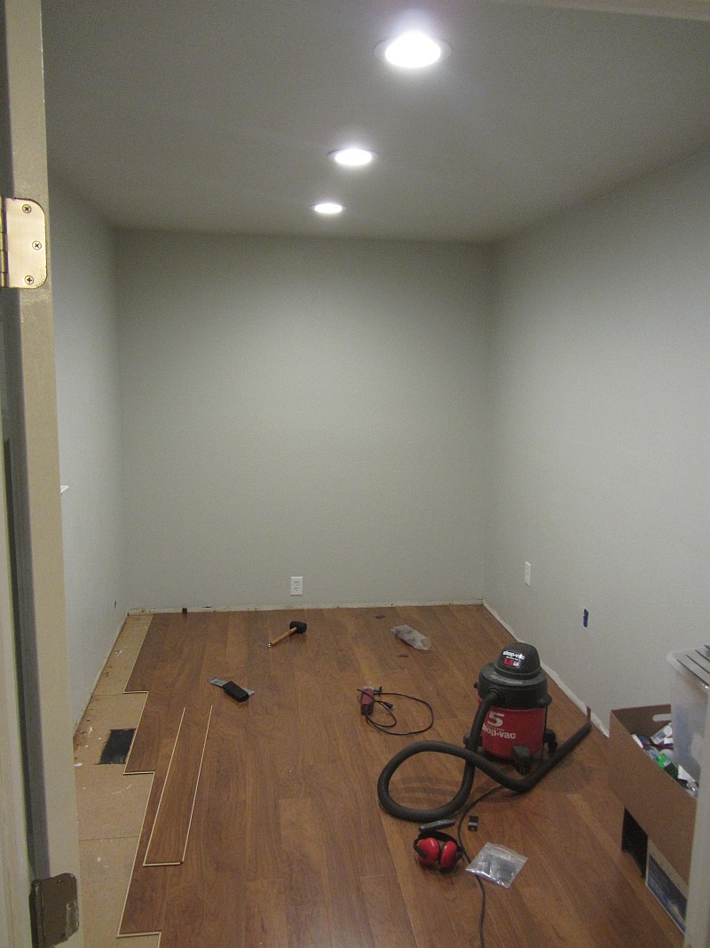

Slowly but surely...

Looks good Nifty. One question; Did you allow for heating and cooling vents in both rooms?
Nifty
Administrator
Nov 13, 2007
1,618
262
237
Great question!!!
The big room had one vent so after the split only my office has a vent, so we'll probably need to add a vent to the other side now (daughters room). That room is closer to a bunch of other rooms with vents, so it may actually be okay, especially since our climate is relatively moderate.
