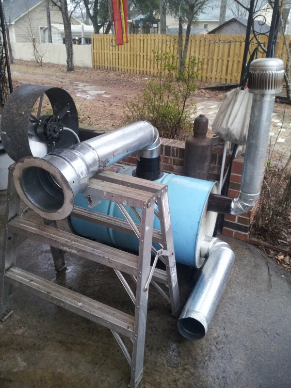

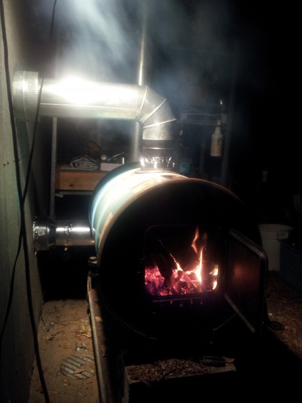

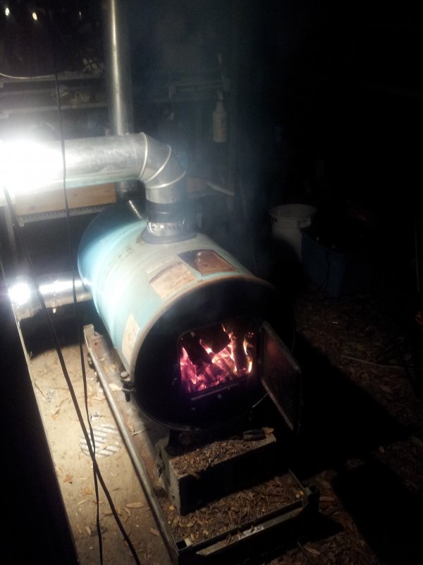

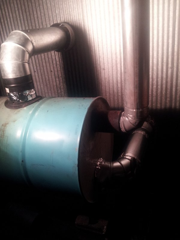

It is funny, I built a forced air wood burning furnace from a 30 and a 55 gal drum and a vogelzang stove kit. It wasn't until a couple of months ago that I found a couple of other people had tried the same thing in years past. So for fun I will post up some of my pictures and commentary.
My firebox is a cut down 30 gallon drum, rewelded into a 20 gallon drum. Which I welded to the back of a solid band top for my 55 heavy gauge drum. The forced air enters the bottom of the drum in the rear and circulates in a vortex, after being directed by a baffle, around the firebox. The air exits the top of the drum and blows into my shop.
The firebox has firebrick in the bottom and a nice baffle at the top to keep the flame from blasting up the chimney.
Next month I will be tapping the chimney to heat water.
So far the paint on the exterior of the 55 gal drum has yet to be damaged. The forced air does a great job of exchanging the heat. The first tests of the furnace really surprised me. At full draft in the firebox, the air entering the shop will cause quite a discomfort to your hand 3ft back from the vent. That's when it is 40deg or less outside. Once I shored up all the air leaks and placed a simple heavy mil black plastic barrier across the rafters (until I properly insulate the flat membrane roof), the temperature was very comfortable after only 30 minutes. That's in a 1000 square foot, bare concrete floor shop.
I built the furnace because I use volatile solvents in my work and couldn't risk open flame inside my building.
