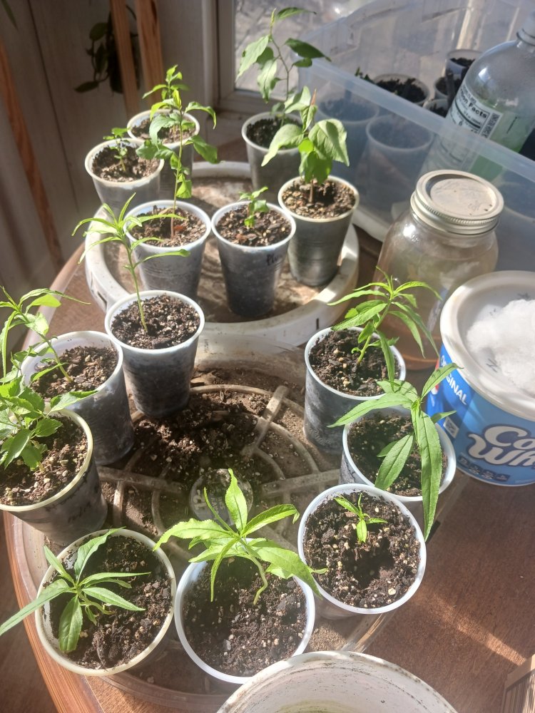

My process is basically shotgun-STUN. Plant any seeds I can get my hands on, let them fight it out. The 5 apricots and 5 peaches are the survivors. I planted dozens of seeds for each, and many died. Most died either on transplant or during their first summer.
By not coddling them, I now have trees that will likely survive anything my environment can throw at them. If they don't produce good fruit, I'll have rootstock that thrives in heavy clay, spring floods, cold winters and summer drought.
I had no survivors from the almonds, cherries and plums, because of my failure in choice of location. I wasn't aware that all the water drained to that area, so during spring rains they sat in a puddle for weeks and drowned. The water drained downhill from the peaches, apples and apricots. A matter of only a few inches, but it made a difference.
Trying again next spring, in a different area.
I planted the seedlings as little as a foot apart and after losses I ended up with 5 - 10 foot spacing. If you're dealing with a preferred cultivar that process is impossible. The rootstocks of grafted trees won't take that level of neglect.

All the fruit trees have gone dormant. All 5 peaches survived the summer. All 5 2nd year apricots also survived. 2 almond seedlings and an apricot seedling survived in the dry garden; clay soil, no mulch, watered only once. We'll see if they survive the winter.
I have plums, Nanking cherries and grape seeds in the refrigerator. Almonds sprout within a couple weeks so they'll go in late January. Pecans and oak seeds will be planted straight in the ground.

All the plum seedlings died. I have 1 survivor from the second set.
My baby peach trees (two years old) are absolutely thriving; far more new growth on them this year than the grafted trees.
The baby apricots are doing great but not as great as the peaches.
The dry garden survivors got "trimmed" by the resident rabbits. May still be alive. We'll see.
This year I put the apple and pear seeds straight in the ground, protected by a board on either side. We'll see if they survive better that way. I am tired of planting perfectly good seeds, having them emerge and thrive, then die because I forgot to water them, or the chickens got to them, or...or...or...
I'll save the cherry project for later, when I can focus just on that. The two I need that I don’t have survivors for yet are plum and almond.
