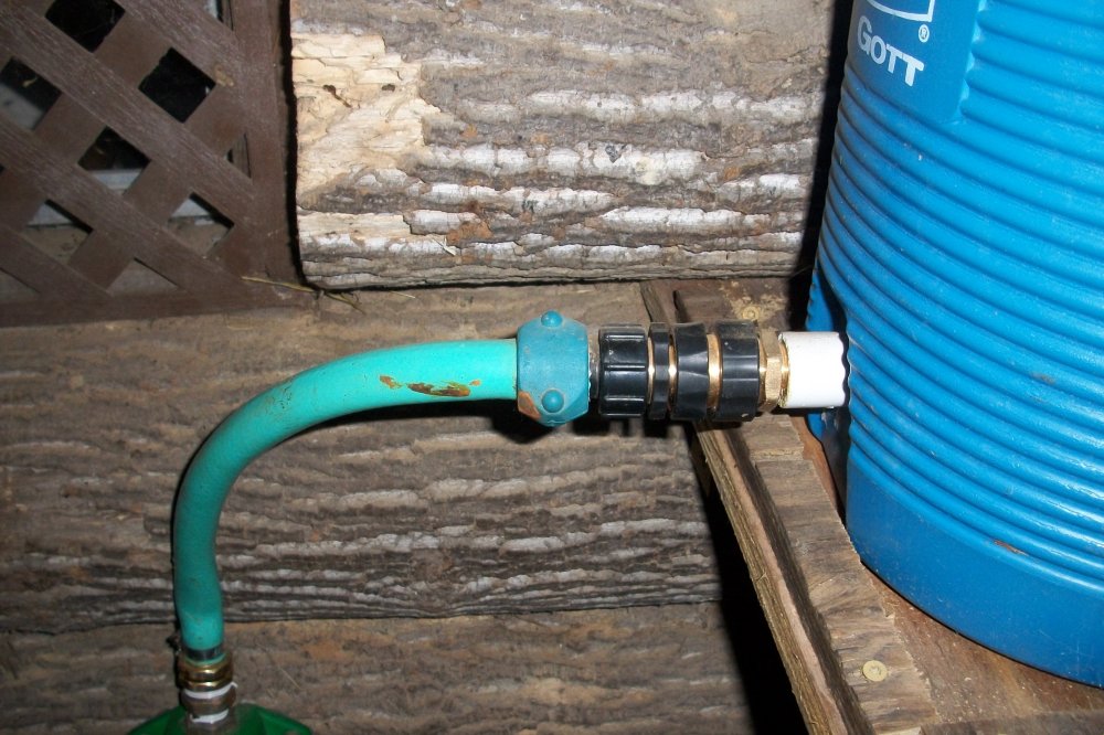

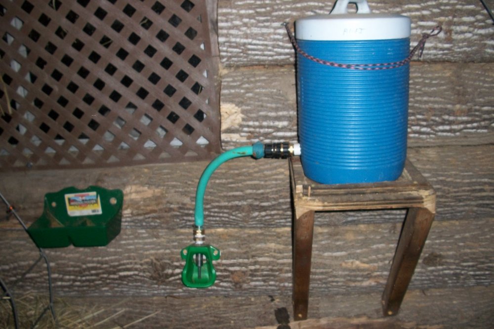

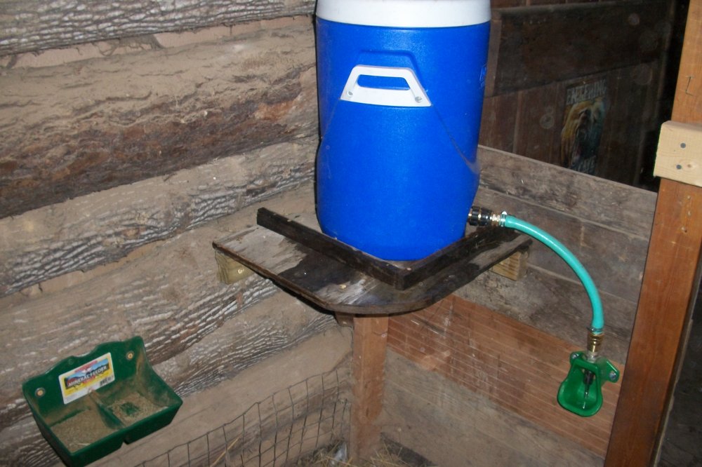

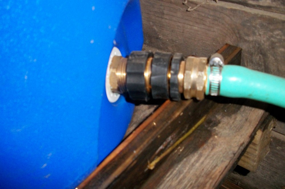

Here you go, Bay. The larger cooler system has a small leak at the quick connect junction due to me having that whole hose under too much tension, putting tension on that junction.
I have a quick connect on the smaller cooler but no tension exists, so it doesn't leak at all.
The quick connect is so I can disconnect those quickly, without having to unscrew them, for cleaning or moving to a paddock system. I used pieces of an old garden hose we had in the farm junk pile, just bleached it out really well prior to use.

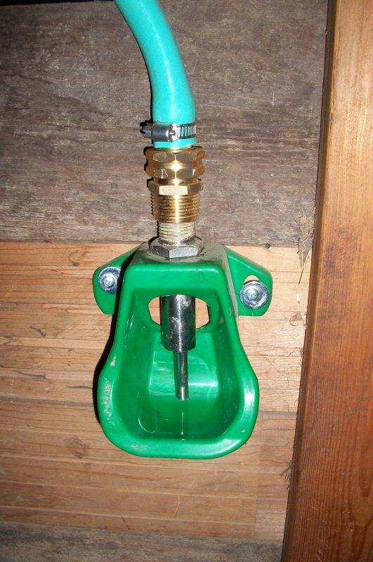

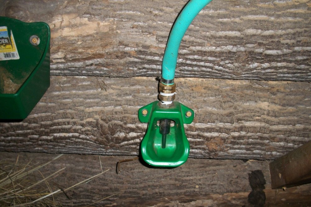

As you can see, the bowls are tiny....they looked bigger than that in the pics on Ebay. I'll be getting larger basins/bowls to go with these nipples so the girls can use it better.

I really like that. I have considered something like that for my chickens when I finally build a permanent coop. Right now I have chickens in 6 different places. I want to build a good sized coop with a 16-20’ run. I’m going to slaughter down for winter, done the roosters, got to slaughter and can 10 old layers. Then I wouldn’t have to fool with those gallon waterers.
